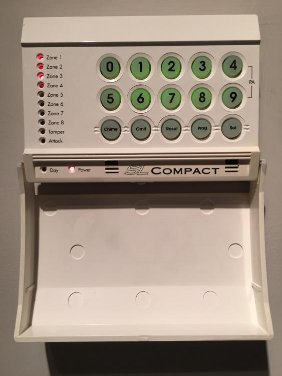

Hello all. It’s been a while, my Honeywell SL compact has gone a bit mental again. PIR was triggered in an outbuilding and in an attempt to silence it, we seem to have slipped into programming mode (i think) and for the life of me cannot get out of this mode. Please if anyone is familiar with this system - and can assist in walking me out of the current state back into Day mode....? I would be forever great full.....

PSE - actually i did follow your suggestions, but on walk test I discovered the problematic zone was actually Zone 4. I had been troubleshooting Zone 3 originally - it transpires my engineer had written it up wrong on the panel... Oops.... -

UPDATE I finally managed to get Honeywell Tech support to speak with me. We went through some investigations in prog mode. Discovered the problematic zone was programmed as 'Key Switch' now its disabled from this function it is behaving normally again. (( I don't know what the function of 'Key Switch' is normally - can anyone tell me? )) During diagnostics I also discovered 2 further zone programming errors, Zones 2&3 were Entry (should be alarm) and Zones 5&6 were inhibit (should be alarm). All reprogrammed correctly now. Thank you to forum members again for your input & suggestions. P.S you should know, despite not being in the industry I find the topics you cover & discuss very interesting, great approach by your members. Makes good reading.. -

To confirm the above, I've PART SET the system. Approached PIR 3 (should not be active in the part set) and the speaker started to chirp, as if entry activated. I switched off at panel. Also in DAY MODE this PIR behaves in exact same fashion. PSE - I've followed your instruction to identify attribute for Zone 3. Led 1. was illuminated. According to your key, this is security ? I think I need an engineer familiar and knowledgable with this panel to reprogram my system. Unless I can get Honeywell to provide telephone support and talk me through the re-programming. I did call them a couple weeks ago, at this time they advised me they no longer provide telephone support for these systems (which I find disappointing) Any further suggestions / views welcome. -

Al-yeti I'm hoping someone here will be able to instruct me... lets see in the mean time I will continue to omit that zone in all instances. andy - now you ask I will need to walk test it to remind myself exactly what it does. Had so much noise from the thing the last few weeks I'm not entirely sure anymore. i think from memory, wether the system is FULL SET, PART SET or in DAY mode, if you approach this particular PIR the panel begins to beep asking for the code (similar to when setting the alarm on exit or entry) however no one is ready to react at the panel so we almost always end up with sirens blaring a few moments later. So its basically acting as a SET BUTTON (make sense?) i will run a walk test to confirm all of the above and re-post though... also I will look into the chime suggestion from James & yourself. -
I have a Honeywell Optima alarm panel, with seperate Led Keypad. One morning in the early hours my son (half asleep) mistakenly identified the kitchen clock radio blaring as an alarm activation. During his attempt to shut down the alarm (which was not even sounding - actually the kitchen radio was sounding) he entered programming mode and has inadvertently affected the alarm settings. Now PIR no3 is permanently on alert. This PIR is located on upstairs landing. Whenever anyone passes in front of this PIR the alarm immediately activates. Even if the system is in Day mode it activates an alarm. When the system is part set during the day to outbuildings, this PIR activates the alarm. When the system is part set at night, this PIR activates the alarm. and so on....... Currently when selecting a part set I have to omit zone 3. Also I cannot leave it in Day mode, I have to select a part set and then omit all zones. Very frustrating. I contacted Honeywell for telephone support, in the past they have assisted me in resolving a different issue & testing the system. However now they inform me they no longer provide telephone support for this. Apparently they only support thermostat systems ? So I'm here again, hat in hand lol Would greatly appreciate any advice or assistance you guys can provide. P.S I have the manual downloaded already, but I struggle to follow it. I am good with instructions normally - but these manuals seem to speak a different language altogether... Dan.
