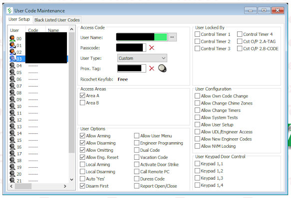

  3. Okay, so I followed Mark's instructions and edited & saved the settings in wintex. I scanned the fob. It asks do u want to arm? I chose part-arm It asks suite A or B I chose A It now wants me to exit the front door in order to activate the alarm But I'm trying to set it up so that I can activate it at night, i.e. front door needs to remain closed.

  8. Thank you sixwheeledbeast. On prev page, where I've posted the Area3 screenshot, it already is Timed Exit. Also you say you wouldn't use the Area Arm suites, but this is now becoming confusing, because I'm not sure which options need to be enabled/disabled as I've got two different advises.. Could I please ask u a big favour? Using all the screenshots that I've posted, could you please draw or at least clearly explain PER screenshot what you want me to change, enable or disable.
  9. Thank you Mrhappy. As you can see, I've updated it and now when I arm the alarm and press the "PART" button on the keypad. Normally I would get the choice menu which would allow me to choose Bed alarm 1, but now I get the choice of Suite01.ArmArea A. After choosing this, there is no timer countdown at all. Instead I have to open and close the front door to activate the alarm.
  10. Mrhappy and Sixwheeledbeast - I'm really sorry guys, but you'll have to be very specific for a dummy like me. What screenshot are each of you referring to and what options do I need to enable/disable? Thanks again
  11. I think it's easier if I posted screenshots for you to check. Please let me know if you can spot any mistakes. Thank you.
