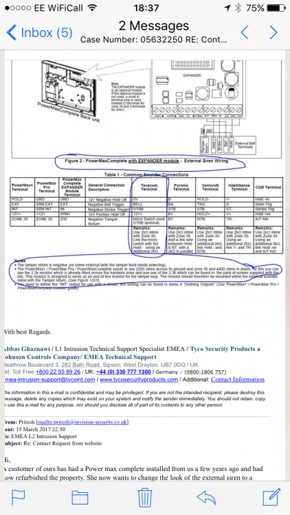

  1. Morning all, Just a quick update. Ive managed to get the odyssey x-be wired to the powermax panel. The tamper works perfectly and the panel picks up the trouble so happy days. Thanks for all the feed back and support. much appriciated.

  5. Hi All, I did read many post on the forum before starting this one so please excuse me im im repeating someone else question. Im in the middle of trialing a Texecom Odyssey bell box (X-BE) with a visonic powermax complete. I have connected the expander module and that works fine as I also tested a voice box. Now, when it comes to this siren im getting a strange tamper issue. When I open the lid to to release the tamper on the siren the powermax complete panel shows no trouble lights but still says Not ready to arm (z30 open) however I have the siren ringing (because the tamper is open). Weirdly when I close the tamper on the siren the trouble light flicks on and says Z30 is open. I have connected it just as Visonic have said and also enrolled Zone 30 as 24h Audible. connections on Siren to expander A: 12V+ >>>> SRN+ B: Bell >>>> EXT C: Tamp >>>> Z30 D: 0V >>>> GND S: STRB >>>> IN- I have also linked the Tamp with a 2.2K resistor to 0V in the siren aswell use an addition 2.2K resistor inline with z30 on the expander. Could someone tell me if im doing anything wrong? Any help would be appreciated.
