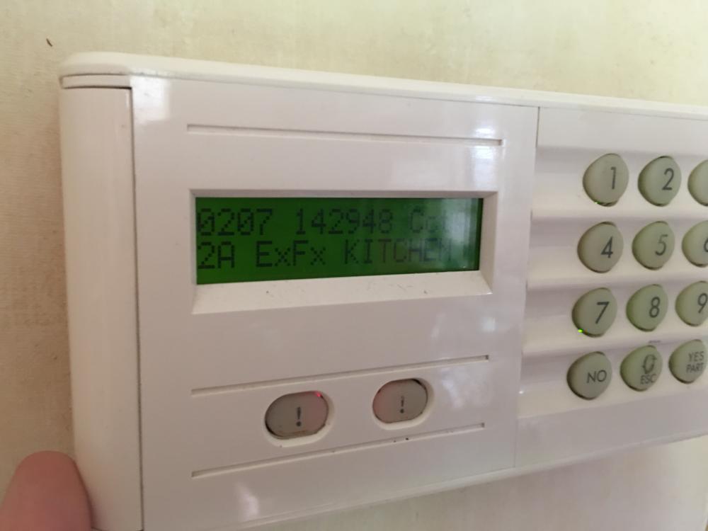

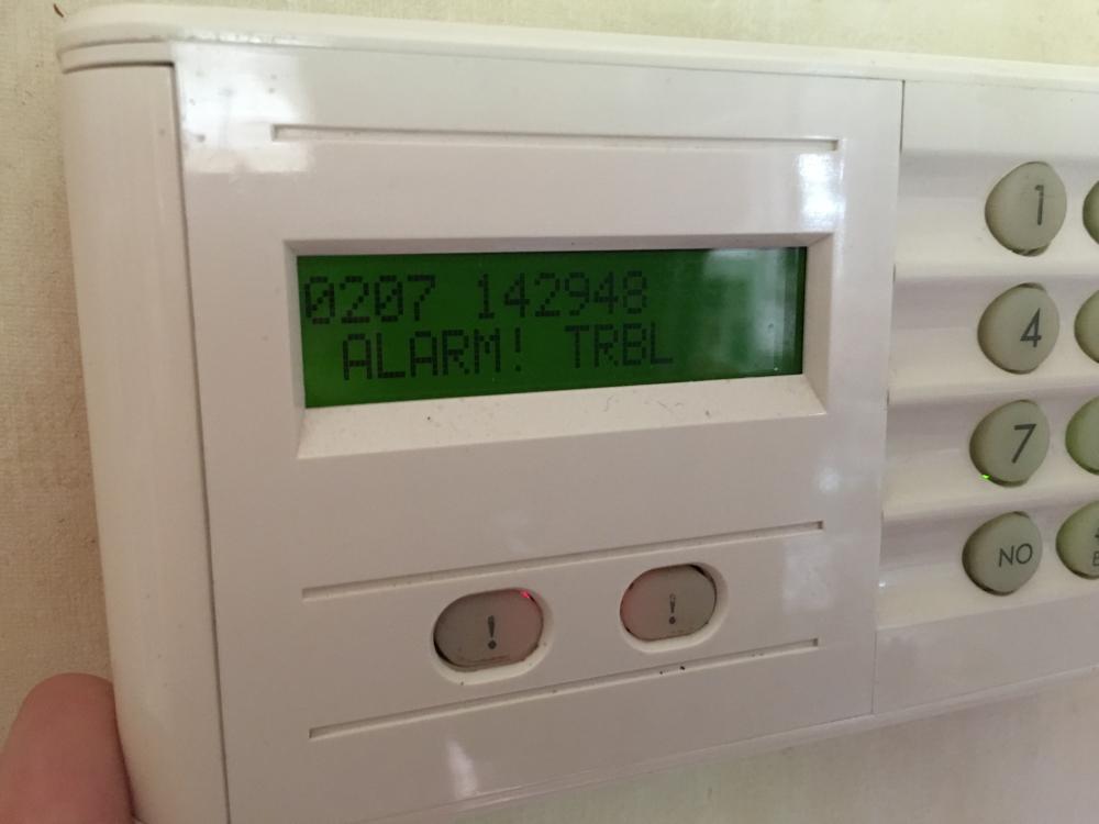

  11. Have checked either side of the log pics shown but only shows being set 5 days prior and entry info when I unset the system 1 day after the alarm. I had been away for a few days, must have re-set itself. Thought about changing the flush door contact as a starter. The kitchen PIR was not active as only a part-set which I use normally. Same log info shown when what I described in post #1.
  12. Garage does have a detector on up and over door but not used now permanently locked, can't remember when last serviced. Used as part set as cats always left in house Must be 20 years plus!
  13. Can anyone suggest what is happening here please. I have an Abacus 6 installation which has recently started to give this problem. On leaving the house a couple of times this week and leaving through the final exit kitchen door into my garage, I get the usual good set beeps and the system has set. A couple of minutes while I have still been in the garage, the system has gone into alarm without warning. On checking the log the message shows CctA 2A ExFx KITCHEN and ALARM, TRBL. I am thinking maybe a faulty kitchen door contact but would have thought if contact has been unmade, I would have heard the entry warning beeps before going into alarm as I do if I open the door on entry as normal? Any pointers please?
