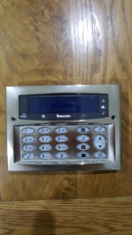

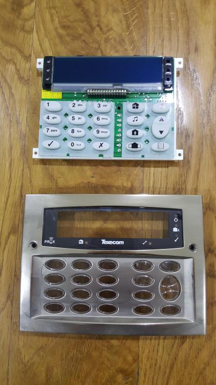

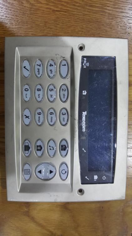

Today's fun fact.... All Texecom elite remote panels are chrome underneath . Here's my recent eBay purchase, at worst a temporary panel until the one we want turns up, or a renovation job. I've stripped it down with the intention of buffing the screen then spraying the rest... As luck would have it, it already had a good finish under the satin silver. Not my favourite colour but due to its size its now going under the stairs, so won't matter a huge amount. Not bad for a 45 make over -

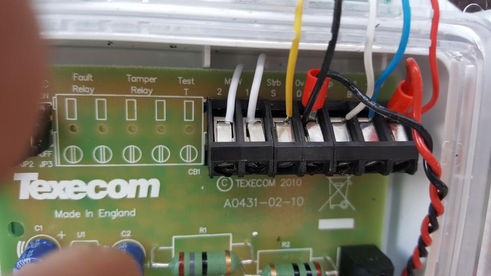

Thanks, so because my bell is grade 2.... It's less protected. What is the single tamp for that's in the five cables.... -

Will give that a go on Saturday. Do I need to short the bell tamper at the panel. -

I agree, we're mere mortals. This has come about as I still have an auxiliary fault and bell fault on the panel. Siren showing left LED flash which indicates open tamper circuit -

So that assumes that it is indeed a tamper.....but more of a tamper between 1st and secondary units -

no idea.... Texecom support said to connect them, but the FULL installation manual shows 3 diagrams for various siren circuits, 2 of which have these terminals - all with nothing attached to them. Looking it appears the X-BE Odyssey box is Grade 2, hence the lack of tamper relay - the X with a double siren, is grade 3, so imagine that will have the tamper relay. Think my only option will be to short the tamper circuit at the box Presume the single tamper wire of the 5 connected terminals will set my box tamper device stopping anyone (opportunistic) from messing with my front alarm box.... -

Page 36 of the installation instructions shows the MSW as always empty...... on the Premier, Prem elite and sirens.... -

Is the MSW the tamper? Ive already connected the 5 connection points Tamper,bell, strobe, 0v and 12v - leaving the 2 MSW terminals...these are the tamper circuit are they? -

Yep Grade 2 Premier sounder - the new X-BE. It only has those 5 contacts and then 2 additionals which i read, should be left alone with MSW written across them -

Thanks chaps.... I've now got all the wireless stuff fitted - still have bell tamper and aux tamper showing for the X-BE bell - although I'm still to activate the battery in the box and finish commissioning instructions (Global options). That said it sounds like i need to omit these via the panel as the X-Be only has 5 contacts - Tamper,bell, strobe, 0v and 12v... where as other models appear to have a tamper circuit additionally. -
