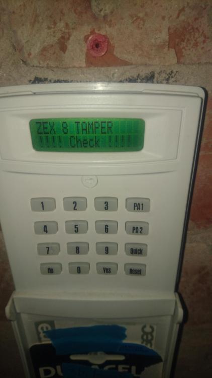

hi all . Any ideas on this. have isolated the pir . seperatly taped up red and black wires to it. and have joined tamper wires together and taped up and zone wires together and taped up. key pad is working in engineer mode as got the code. issue now is it is coming up with a internal alarm saying: bell box tamper fault. Then saying zex 8 tamper check !!! the bell box is not flashing and no lights . am i correct in assuming it because this 1amp fuse is blown in the panel ? the second fuse in the panel i am waiting to get. what else can it be? does this fuse control the pir. Door sensors and bell box ? Any one know?? -

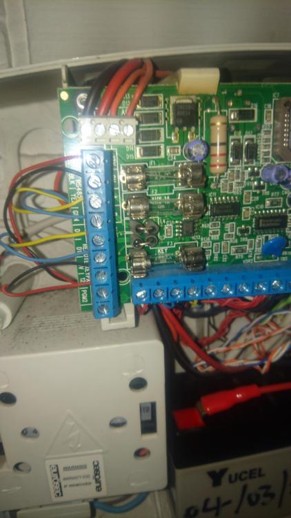

Thanks for that information. As soon as i get the fuses i one in and try it. Hopefully it wont have defaulted to another code as i wouldnt know what that would be. I am just assuming the bottom fuse in the picture is the fuse for the illumanation of the key pad? As it says on the board key.....? And the one that has blown controls the door and pir sensors and key pad???? -

Thanks for that information. Strange this. Have just come home now off shift and i have noticed that the key pad is illumanted and saying unset. It was off yesterday. Very odd. However it is saying 2nd january 7.31 time. I have tried putting my security code in in but it doesnt respond. Would i be correct in assuming it will not fully work until i replace the one amp fuse that has blown Then i will just have to change the time and date . Dont know why its saying this date etc or why it has now come back to partial life as was dead yesterday.... Please see picture of what fuse is blown. Its the middle one. Was thinking that the bottom might have blown as thought that looks after key pad but it was ok upon removal and checking.. -

Hi. Had a bit of chew in with this. Put alarm in to engineer mode. Then disconnected the wiring to the pir in room . Managed to touch the red wire to some thing when pulling cables back out of pir. It set the outside siren off saying tamper 8x on the keyboard. Outside bell box went off for about 30 minutes. Had a look inside control panel . 1amp fuse is blown , other two fuses the 250mill amp and the 2amp are ok. Went back in the house and now have noticed the keypad is dead. Went to try and get a 1amp fuse . No chance on a sunday.... My question is is the siren likely to go off again or not ? It hast for last 6 hours but thinking it might just be charging up then will go off? I have individualy taped the 5 wires up from the pir . Nothing i can do tonight Apprently there are varous speeds of 1amp fuse. . From F to T version . So will go to electrical factors tomorrow if i get chance with blown one . Just hope alarm wont go off tonight. Alot to be said about bagging the sensors . Well to late now. Think will be ok?? -
