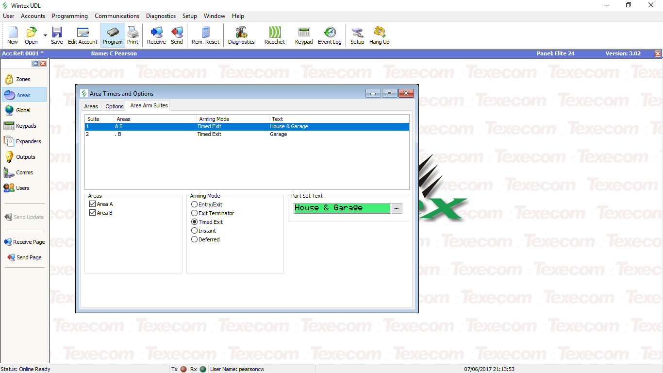

Okay so here I am yet again scratching my head.... I changed the zones garage sensors (motion and door) to area b and all the house sensors to area a. I renamed the arm suites; Suite 1 - AB House and Garage Suite 2 - .B Garage I swaped the Part Arms in the zone setting Part 1 - Bedtime (first floor omitted) Part 2 - Doors and garage (house motion sensors omitted) Part 3 - Garage Only (All house omitted) Quick Arm is ticked for both keypads Both keypads set Area A&B When I press part upstairs it offered me area b so I changed the keypad setting on the second keypad setting to "Use keypad areas" It then offered me Areas A&B but then when it set it displayed "Garage" When I press part it says "House and Garage" then I press part again and it says "Do you want bedtime" So I assume the second keypad is somehow linked to Arm Suite 2??? Is there a way I can change it? Any ideas why the part isn't just defaulting to part set 1? Thanks in advance :-)- 25 replies

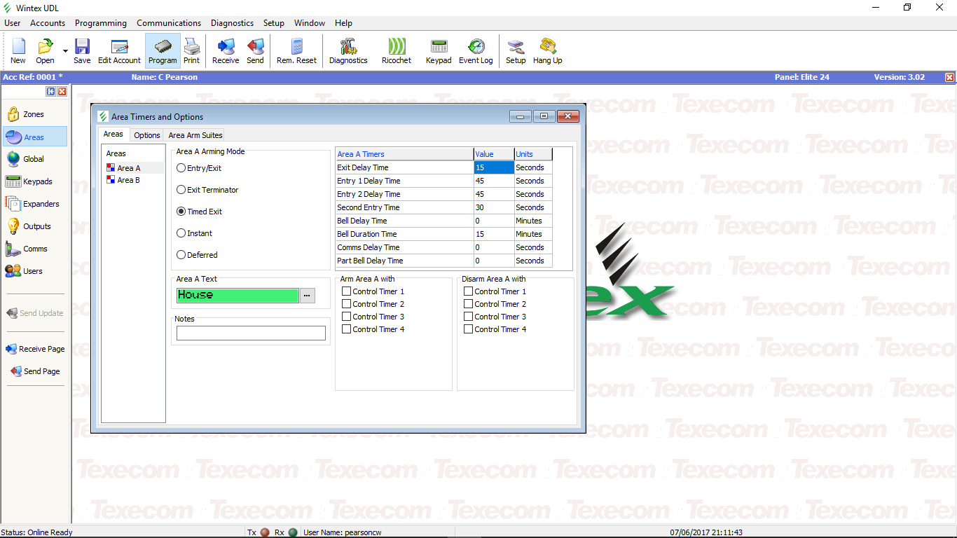

Hello Everybody, I'm hoping you can help me with what is (hopefully) a relatively simple fix; I upgraded the firmware on my premier elite 24 panel from 2.(something i cant rememeber) to 3.2. Since doing so when i press the area button on my control pad in the hall the system goes to part arm 2, The system is set into 2 areas; Area A = Ground Floor and Garage Area B = First Floor The control pad in the hall is set to Area A&B but I havent got the "use keypad areas" box checked in wintex, I tried it and it made no difference. The second control pad is in the second floor landing, This is set to area a only, the idea being that I set the alarm from the second floor pad at bed time and we can roam the first and second floors (no sensors on second floor) and then either dis arm from second floor in the morning or go down stairs and the hallway sensor will start the entry timer. The Parts arms are as follows; Part arm 1 - Doors and Garage Part Arm 2 - Bedtime - Seperate to only activing area A from second floor pad Part Arm 3 - Garage Only So before i updated the firmware it all worked beutifully, I press area in the hallway when leaving the house and the whole house was armed, and i pressed area on the second floor pad at night and only the grond floor and garage was armed. Like i say though, when i press area on the ground floor pad now it automatically goe's to part arm 2. I even change the configurations on part arm 2 so it was the garage only setting and part 3 was the bedtime incase something in the zone settings was confliciting but it made no difference, even with the garage as part 2 when i press area it still auto's to part 2. HELP PLEASE!!!!!!
