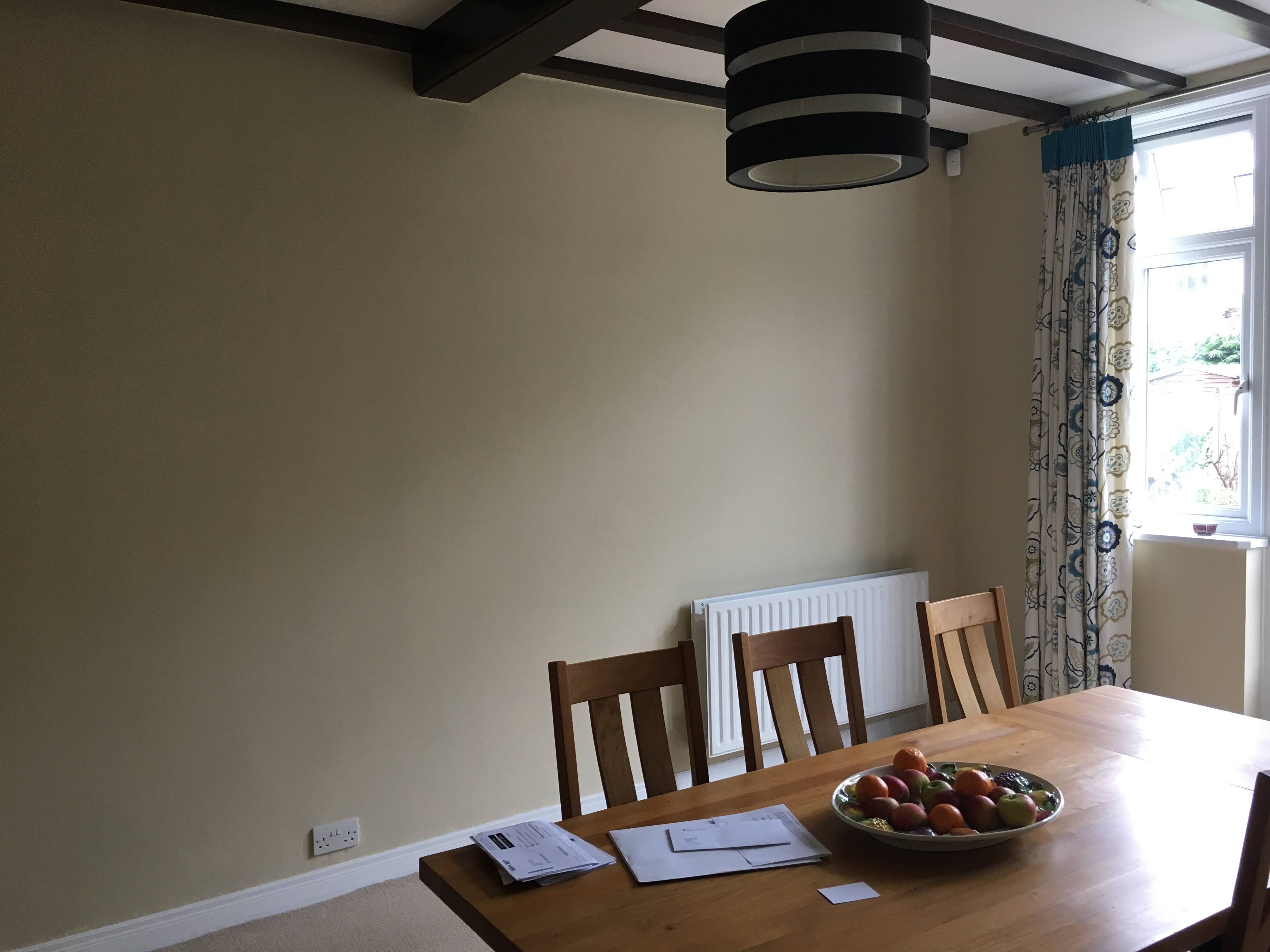

  2. Hi - yes I also considered avoiding the radiator but the other corner would obscure part of room due to chimney breast. I fitted all my sensors at ceiling height to make them more 'invisible' but I could lower as you suggest. Both times this sensor has had a false alarm the radiator wasn't on. It has been on plenty of times when system was armed but never triggered. DT sensor ordered and will be fitted this week but its annoying not to understand what caused the false alarms.
  3. Thanks for the feedback, The dining room where the PIR was triggered is about 17' by 13' with high ceilings. As you can just see by the photo, I placed it in the corner of the wall the window was on looking into the centre of the room. The only reason I fitted 2 quads was that Texecom did a package that was considerably cheaper than buying individual components and came with 2 Quads and 2 Dual's. I had to buy 2 extra PIR's and chose 2 more Dual's as price difference wasn't great. I deliberately picked what I considered to be the 2 areas least likely to be triggered by 'hostile' conditions: landing and dining room. The other PIR's are in Kitchen, living room, hall and garage. The alarm went off last night about 5:30 am, just as it started to get light.
