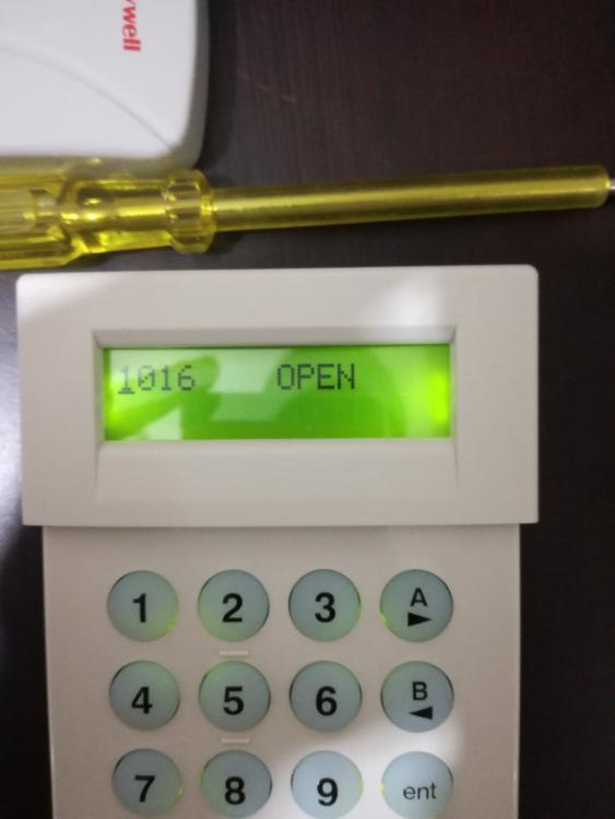

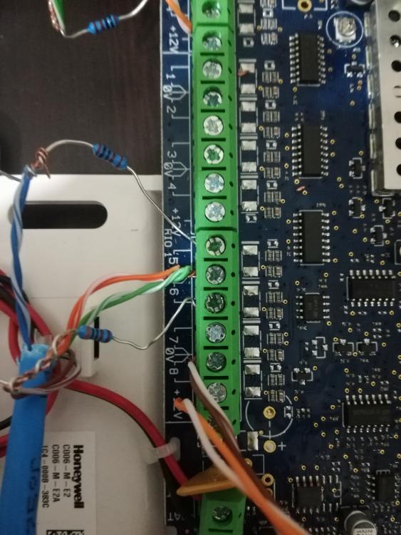

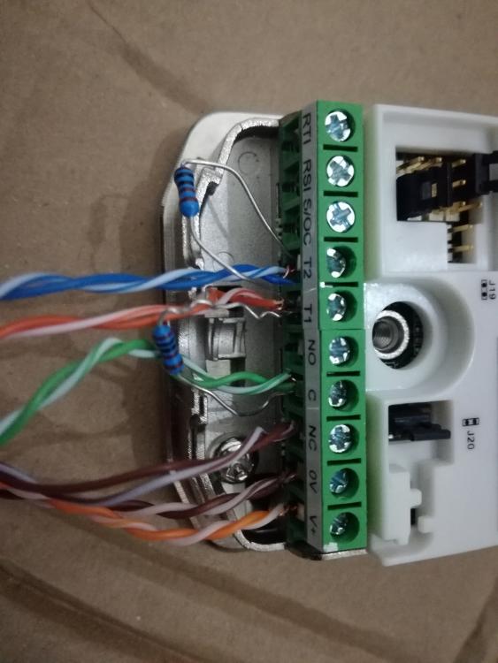

@Galaxy Guyu Guys please I nead help with this antidrill sensor sc100 now the tamper sensor is working correctly once I click the button the state convert from open to closed but the vibration sensor alarm still open and I cannot set my system coz of it so please guys I will share the connection from both sides panel and sensor and please help. Regards, Here is the pics
@Galaxy Guy no I am testing on another one sorry for not clarifying
And fyi ,What I have on the antidrill sensor RTi,RST,T1,T2,NO,C,NC,-,+ and on the panel Z,0V,12V what I am done I removed jumpers 19 "tamper and alarm" and connected resistor between T1 and T2 and resistor between NC, C then I connected NC with 1kohm eol to z1 and T2 with eol 1kohm to z2 and t1 and c on the 0v on the panel
One more thing @Galaxy Guy I have sc100 antidrill sensor and the tamper sensor work correctly but it is not detecting the vibration so can you provide me with the correct way of connecting sc100 to galaxy flex fx050 panel
