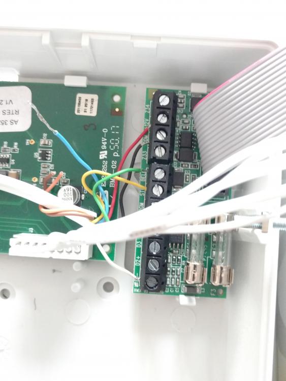

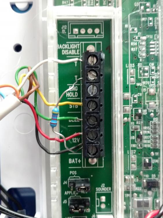

I think the resistor I have in the pics is a 2k2 according to its colour bands.

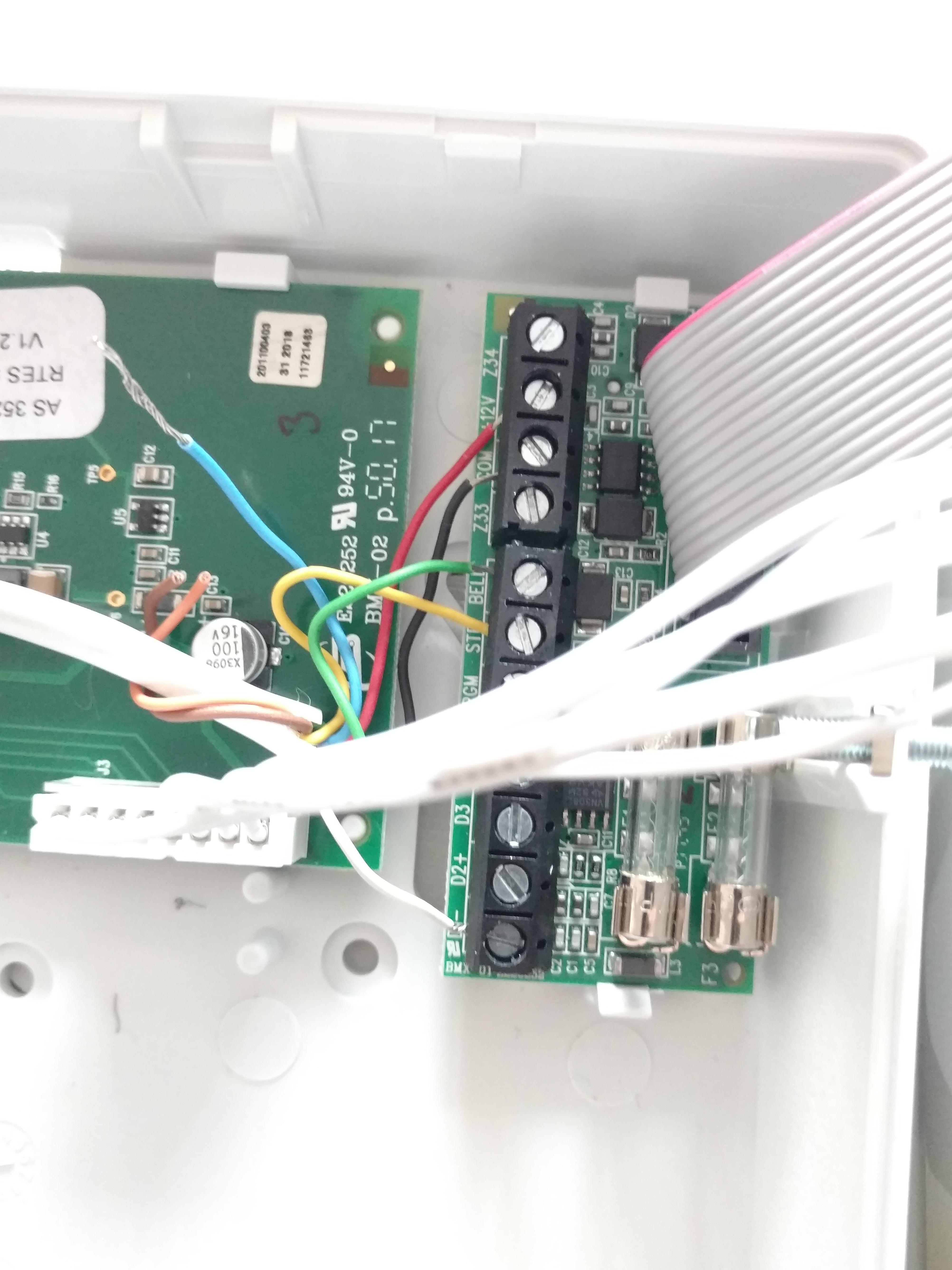

Here are some pics

I tried to upload a photo but the file is to big so : deltabell: from the top terminal white_T resistor_T eng hold_ none stb_yellow bell_green 12v_red negative_black also resistor into this terminal linked in to 2nd T above Enforcer panel Red_12v+ Black_common Green_bell Stb_yellow White_D1 No links or resistors in panel Frustrating grrr Thanks- Pyronics enforcer V10 wiring to Deltabell E
