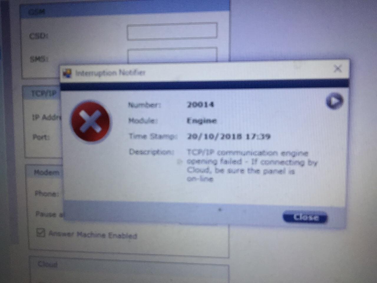

I have defined the TCP/IP communication parameters on the CS - see image. My CS version is: 3.0.0.0127 - could it be I need a newer version? -

Yes have eng manual for panel and manual for config software. CS all running on my W10 machine fine. I can ping my panel responding fine. Tried to do a port scan on the panel IP - see what port it’s listening to-no ports are open.. Went to keypad and into 4) Communication - 3) Config. SW - 3) IP Gateway - 1) IP Address - (have set this to my router IP: 192.168.1.254) 2) IP Port - (have set this to 01000 basically port 1000) On my config software, tried connecting via TCP/IP using local panel IP: 192.168.1.66 with port set to 1000 But getting Error 20014 - TCP/IP communication engine failed - if connnected by cloud, be sure the panel is on-line.
