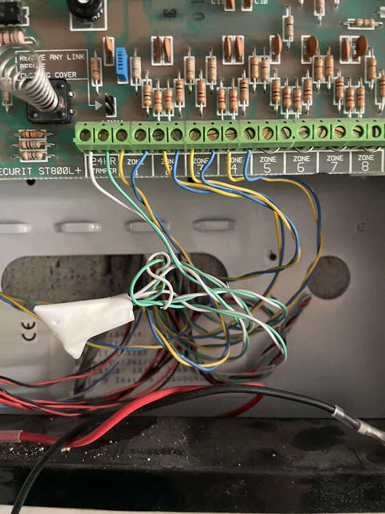

  1. I guess you could say that I am lucky to not have witnessed such awful happenings in my life, but it comes at great cost to me, considering that I do not associate setting the alarm as an important task, I'm quite forgetful by nature and so I rely on the robots to do it for me. Geofencing is an option, even more robust when combined with sensing device online presence within the local network. This is what HomeKit does. I'd like to contain the system to as few applications as possible. Currently running Homebridge & NodeRED.
  2. ? I'm now curious what kind of tech could possibly exists that would make a Phillips PIR any less useful as opposed to a traditional PIR.
  3. @sixwheeledbeast Thanks for the advice and your perspective. Blearing a siren down my street and annoying the neighbours whilst I'm blisfully unaware is not a useful security system in my eyes. Adding some brains to this unit seems like a good way to improve security without breaking the bank. I agree that occupancy sensing isn't perfect, but I must say that soo far, Apple are doing a fantastic job with HomeKit. My current setup allows for the alarm to be set when we go to sleep, and when the last person has left the house. If motion is detected I will be notified silently, but will have the option to sound the siren if I so desire. Hell I could even have the authorities contacted automatically if I wanted. The possibilities are endless! You do raise a fair point, and one that I will consider for the future when I'm able to upgrade my alarm system. I'm just trying to have something rather than nothing at this point in time. Forgetting to set the intruder alarm is our number 1 reason for not using the alarm right now, so I guess my aim is to overcome that, and throw in some additional features while I'm at it.
  4. Yes, I do have some Phillips Hue Motion sensors, which work fine. But I would like a little more coverage and rather than buy more I figured I could use my existing PIR sensors ? I'm sure experienced HA folk would also laugh at my intentions, but I fret not, as yet I cannot see any reason why tapping into the infrastructure from existing alarm panels is a bad idea. Your setup sounds quite similar to what I'm trying to achieve.
  5. Correct, it will not. But neither will my current alarm because we often forget to set it! Some interesting considerations however. Perhaps I could add a backup battery to my board with low voltage detection, in addition I could add GSM module if the WiFi is offline. Is there any reason for using a relay instead of a voltage regulator? The voltage coming from PIR is just a signal right? It's not powering anything as such so would imagine there's minimal current? A more commercial alarm panel would be much more suitable, however that option is not available to me, I would be happy with a DIY upgrade.
  6. I agree that the current alarm system is old and in need of an upgrade, however that option is not available to me at the moment, hence the D.I.Y "upgrade". Thanks for the advise, but I think 5v might damage my board given that it operates on 3.3v. I've done a little research and figured that a simple voltage regulator might be a good solution. I'd like to confirm the input voltage however before purchasing anything. I couldn't find a data sheet or schematics for the 800L - I'm guessing 5v is common for alarm systems? The 800L is rarely used as it is; we're too lazy to set it and would much prefer having the ability to control via smartphone and/or other automated triggers, such as when all occupants have vacated the premises, which is exactly what HomeKit offers. Essentially this project will replace the brains of our alarm, using existing PIR sensors.
  7. Yes, this is exactly what I'm trying to do. Forgive my ignorance, but why? The PIRs are in perfect working order, despite the alarm not being smarthome friendly, why not use utilise the existing infrastructure? Because I'm an electronics hobbysist trying to improve my knowledge by engaging in practical applications; I find this is the best way to learn. I do actually own some Phillips Hue Motion Sensors, which are great, but rather than buy more I thought it would be a good excercise to save money and learn a little.
