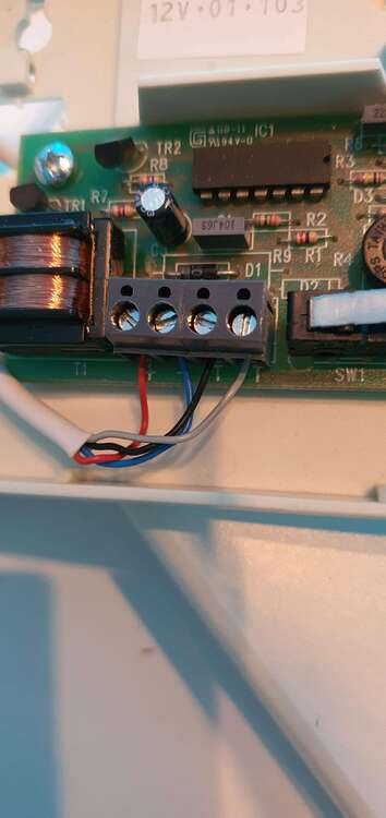

  1. Yes thanks i have set siren on 1002, and now working good.
  2. I have on sire +-TT and on panel Bell +12 v, and T and - BELL.
  3. There is no wires in the way, the wire from panel and siren have i make a pictures.

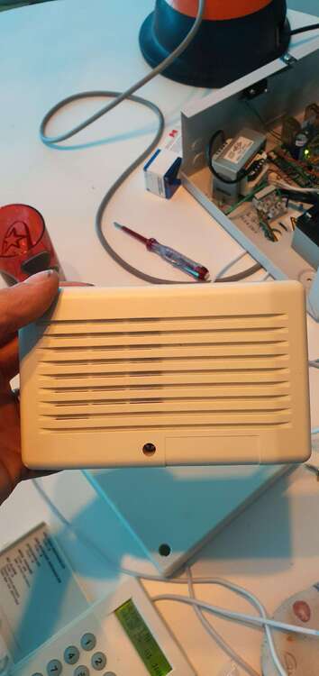

  4. Hi all, I have a securitysystem g2-20 i have a vaiani siren, and wired to panel, but when i put blue cable in - then it will go off, when there is no alarm, i have some picture below. Greetings Michael.
