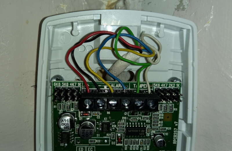

  2. I just disconnected the 12v wires in the box and all was fine when I reconnected them after fitting the new PIRs so I was worrying about nowt really. Just the new one to fit in the garage left to do, and that's for another day - I'm confident I can handle it now though. Thanks to everyone who replied to my questions - I appreciate the help I've had from this community. (Edited to add pics)

  4. So the PIRs arrived yesterday, and I'm looking to fit them today. Is there a simple way to deactivate the 12v supply to the PIRs on this panel (e.g. remove one of the fuses)? I don't want to power the whole panel down as the external siren will go off if I do (don't ask how I know). The only manual I can find is slightly different to the model I have (it's for a unit with 8 zones and mine is 6 zones) and doesn't really help me with that. I suppose I could just remove the most likely looking fuse and stick my meter on the 13v output, but that risk a lot of noise happening.

  7. Thanks swb, I'll check that. Should I be concerned about the level of the DC supply (13.6v measured at the PIR terminals)? It seems a bit high since the PIR is rated at 12v. My meter isn't calibrated of course, but I'd be surprised if it was that far out.
