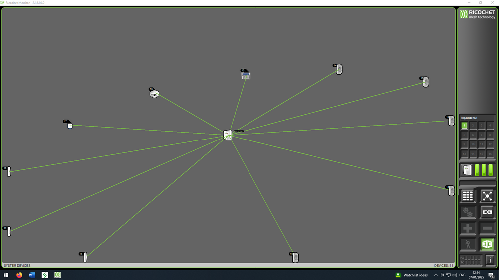

  4. Hi So when i enter my house through the front door and don't put in the user code I am just getting a INTERNAL PANEL ALARM My outside Siren, and 2 indoor ones do not go into full alarm Yet my system is fully set Ive done a walk test and all ricochet are all 100% with no issues! i want the entry to come on says 10 secs but as soon as i hit the PIR Goes into full alarm mode Do you know what the settings are in Wintex or keypad to make it do that? Thanks

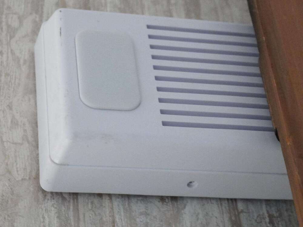

  8. THANKS FOR ALL THE REPLIES how do i do this: You haven't terminated the test terminal at the panel from what I see, so it's not doing the G3 periodic testing which I expected to be part of the issue. Im thinking its that internal siren thats bad! im not sure how to wire that "internal speaker up separately? i tidied up the external and seems okay looking also tidy neatened up the wires all 8 x cores being used, seems ok i can also hear the micro switch clicking etc When i let go of the tamper the external siren sounds! Im looking hopefully at it being at the "control panel side? or that small cheaply made internal speaker!
  9. a close up! Im just thinking guys maybe its the small INTERNAL STROBE/SIREN IVE ALSO Wired up to the same terminals as the exterior bell box?
  10. Does anyone know the settings for it? in the setting up? the way its wired? Im releasing the small plastic cover tamper screw so should press against the switch better and tidying up the wires as i put a nought in the outer sheath!
