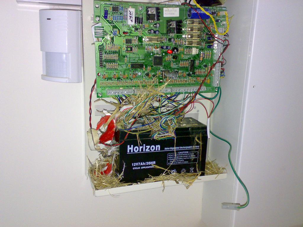

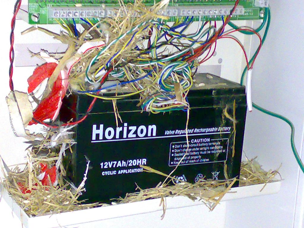

trojan77horse Posted June 1, 2008 Share Posted June 1, 2008 http://www.thesecurityinstaller.co.uk/comm...554_4_30873.jpg http://www.thesecurityinstaller.co.uk/comm...54_4_652663.jpg not sure if previous post went through so here are the images of what i came across when i investigated a faulty alarm system Link to comment https://www.thesecurityinstaller.co.uk/community/topic/23462-re-check-this-out-links-to-pic/ Share on other sites More sharing options...

Guest anguscanplay Posted June 1, 2008 Share Posted June 1, 2008 thats shocking .... no date on the battery Link to comment https://www.thesecurityinstaller.co.uk/community/topic/23462-re-check-this-out-links-to-pic/#findComment-199504 Share on other sites More sharing options...
antinode Posted June 1, 2008 Share Posted June 1, 2008 Looks like an Aritech. How did all that get in there?! Trade Member Link to comment https://www.thesecurityinstaller.co.uk/community/topic/23462-re-check-this-out-links-to-pic/#findComment-199505 Share on other sites More sharing options...
alterEGO Posted June 1, 2008 Share Posted June 1, 2008 Looks like an Aritech. How did all that get in there?! mouse? Link to comment https://www.thesecurityinstaller.co.uk/community/topic/23462-re-check-this-out-links-to-pic/#findComment-199506 Share on other sites More sharing options...
trojan77horse Posted June 1, 2008 Author Share Posted June 1, 2008 i had another post explaining the pics but it didnt get on. yeah, it was a mouse nest. its a HKC control panel (good bog standard) i got called out to fix a fault and when i opened the cover bits of the nest fell out and i was amazed to see it. the mice came down from the ceiling into the electric board and along the top into the alarm panel. there was no cable damage in the panel but when i lifted the floor boards above there was extensive nibbles. i've been in the industry for over ten years and i've never seen that before. when i told the customer that the fault was due to mice chewing the cable he looked at me as if i was a clueless aprentice trying to pull a fast one on him, but i was happy to see the horror in his face when he saw the place where his 'visitors' had been coming from over the last few years. i removed a 1/4 tesco bag full of nest and mouse material from the panel and urged the owner to replace it as the back of the board was filthy, Link to comment https://www.thesecurityinstaller.co.uk/community/topic/23462-re-check-this-out-links-to-pic/#findComment-199517 Share on other sites More sharing options...
