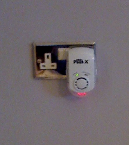

hpotter Posted February 17, 2009 Posted February 17, 2009 When you swapped PIR for another known ok in the building I take it you just swapped the pcb. It might be worth turning the back plate slightly so the "fingers" arnt looking down the same lines. Fitting a different type/make of detector would in effect be doing the same, (unless your unlucky). Just one other poss, - do they have one of those plug in rodent deterents thingymejigs in the hall? Had that recenly when they move RX40 picked them up even though they not visable to it!.
Alarm boy Posted February 17, 2009 Author Posted February 17, 2009 When you swapped PIR for another known ok in the building I take it you just swapped the pcb. It might be worth turning the back plate slightly so the "fingers" arnt looking down the same lines.Fitting a different type/make of detector would in effect be doing the same, (unless your unlucky). Just one other poss, - do they have one of those plug in rodent deterents thingymejigs in the hall? Had that recenly when they move RX40 picked them up even though they not visable to it!. Dont remember seeing a rodent detector although will check on next visit. but as i say i have stood still away from the detector and its fine (no LED indication at all) as soon as you slightly move in the hall behind it the LED comes on every time! yes i did just change the PCB in the detector. Are you saying i should slightly relocate the detector? even pyronix dont know. Im starting to belive the saying "iv got eyes in the back of my head" for the replys Ryan Williams - South coast service engineer for Banham Fire & Security Group* *Comments are my own and do not reflect those of Banham Fire & Security Group.
