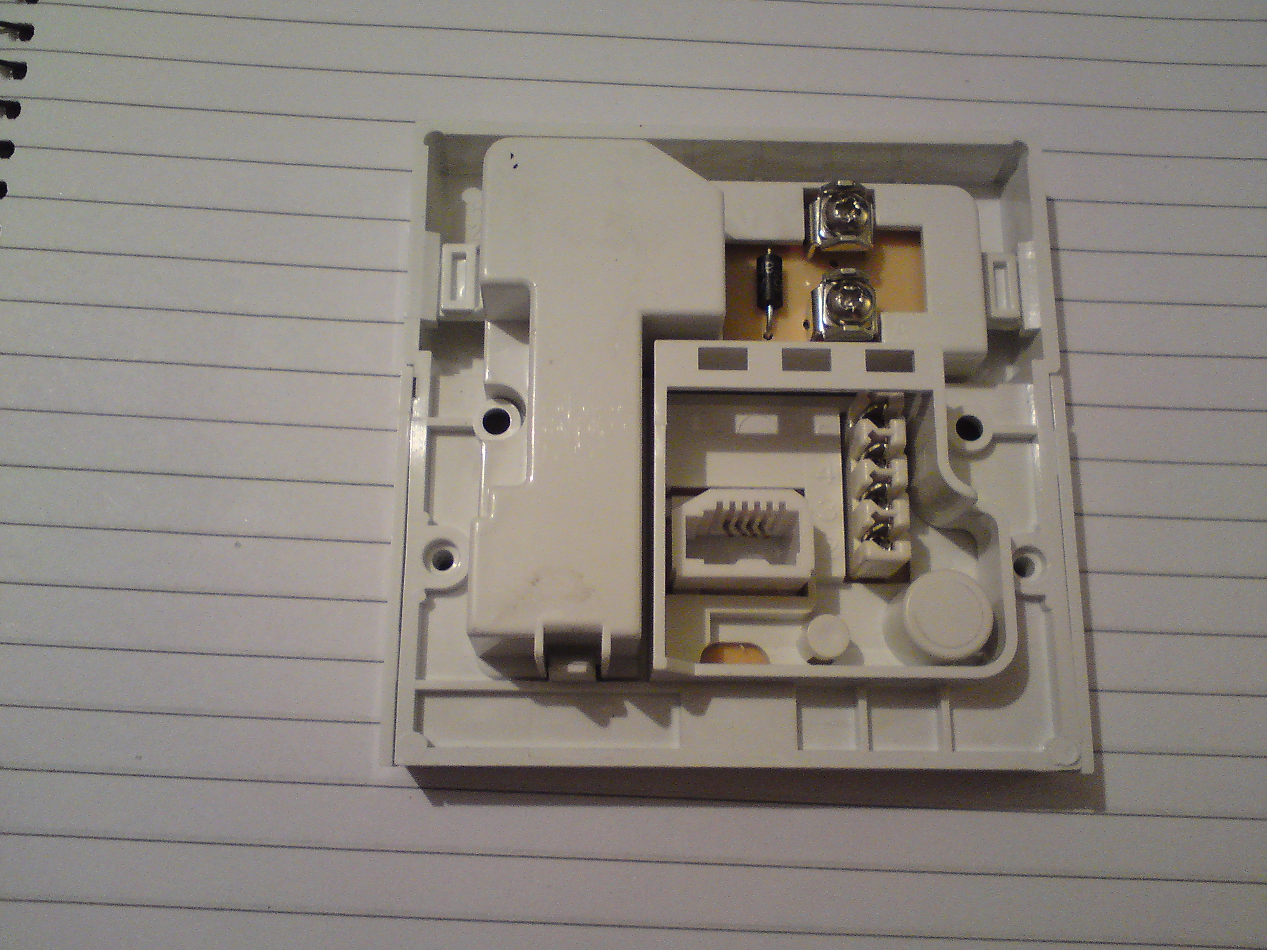

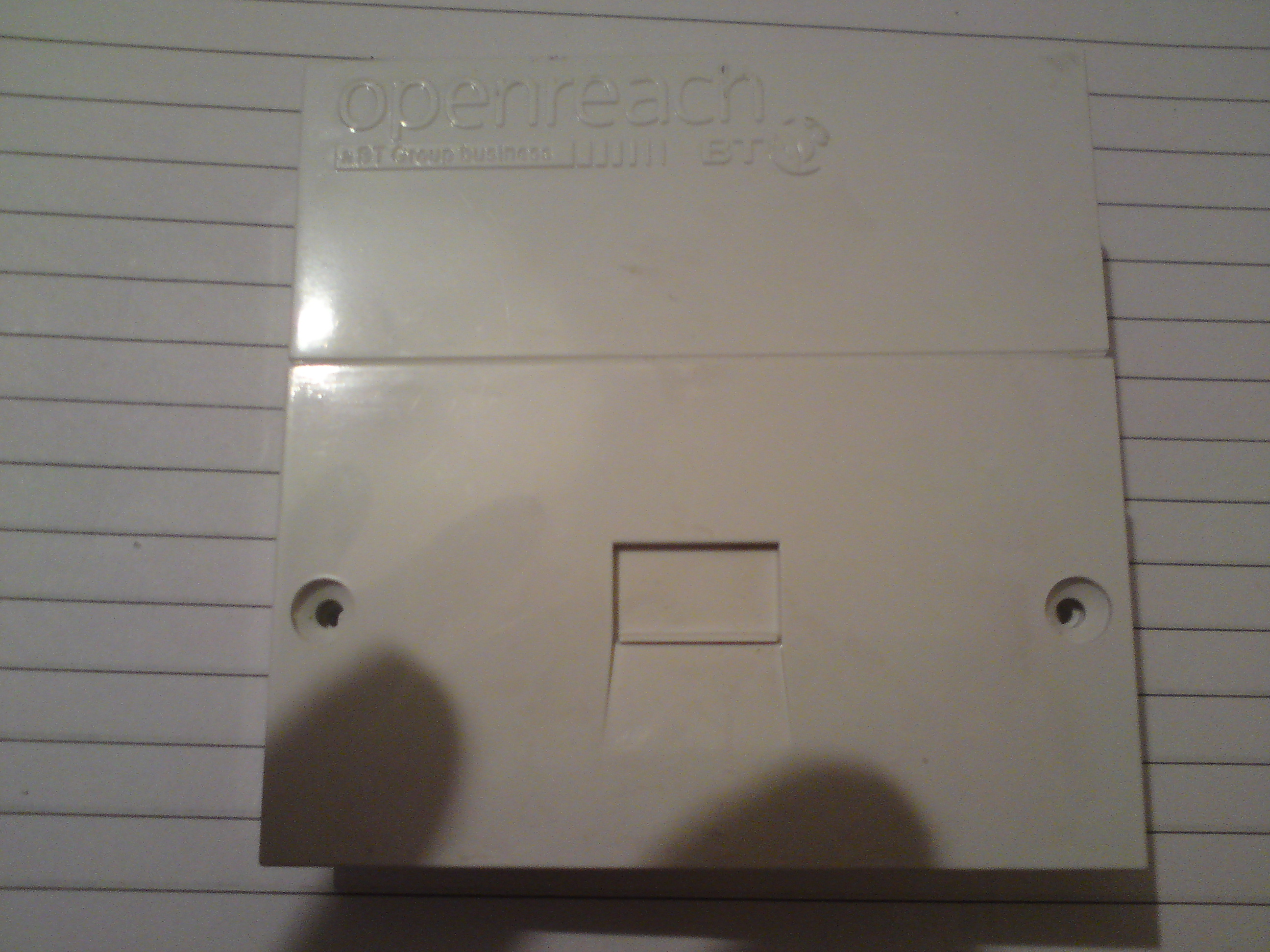

Rulland Posted February 13, 2009 Share Posted February 13, 2009 This is what I was given-I note there is a 'lump' where a capacitor could be! But it aint got phone out/BB out on the front as you can see-just a BT jack out-but it does say BT openreach on the front!. Does it filter ALL in the house no matter whats plugged in?. Richard. Link to comment https://www.thesecurityinstaller.co.uk/community/topic/26933-auto-dialers/page/2/#findComment-224612 Share on other sites More sharing options...
A-G Posted February 13, 2009 Share Posted February 13, 2009 A central filter will filter for the whole house ..... but surely you can still use other filters as well. I'm sure that's what I did at my last house . . . PM me for access to the SSAIB members discussion area. Link to comment https://www.thesecurityinstaller.co.uk/community/topic/26933-auto-dialers/page/2/#findComment-224613 Share on other sites More sharing options...
