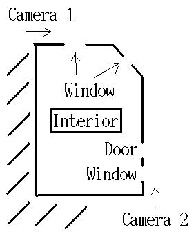

NMBCamera Posted April 2, 2009 Author Share Posted April 2, 2009 Hi, again thanks for your replies >>> ian.cant Are you referring to Mr Mifsud the maltese football player with Barnsley? I'm sorry but I don't know a heck about football. As regards your flight, I'd gladly pay it however I hardly have enough money to finish my new apartment, therefore I think you will have to fork out 20 quid and catch the daily Low Cost flight from Luton airport. Nevertheless, if you are coming to Malta, send me a PM, I'll be glad to have a couple of pints together. Now, attached is a primitive plan of the of my apartment. As I said it stands on a corner on the ground floor, and there is not more than 8 meters from where the cameras are positioned to the corner. When the corner is reached there is coverage by the other camera. So are two cameras enough? So till now I learnt that: Wired cameras are better than wireless DVR is better than PC because it is specifically designed for the application I have to check about the lighting at night, however I prefer playing safe and Installing IR immediately. I should get something from a local supplier, but I'm asking questions here so that I know some information beforehand and they don't sell me just what's more profitable to them. Some more questions: Do cameras have seperate wires for power supply and video signal? I mean, do I have to prepare two wire ducts, one for the electricity cable and one for the video cable, or should I just prepare one wire duct to the DVR? So what do you people think? Thanks N Link to comment https://www.thesecurityinstaller.co.uk/community/topic/27864-some-advice-on-a-new-system/#findComment-231908 Share on other sites More sharing options...
ian.cant Posted April 2, 2009 Share Posted April 2, 2009 I thought nearly everyone in Malta was called Mifsud its the equivalent of Smith in the uk is it not? I wasnt refering to the footballer though although i do believe he's a good goalscorer. Two camera positions seems fine on the face of it although there will be a sort of blind spot on the angle, i presume it wont be possible to get there without going throught the field of view of either cam 1 or 2. The camera's will need a separate cable for power and video signal although it is possible to buy composite or shotgun cable which is basically power and video wires seperate but within the same cable. I hope that makes sense. If you buy low voltage 12v or 24v camera's as opposed to mains power 230/240v/ac then both the power and video can be run in the same Duct or containment, mains powered camera's should have the power run in a seperate duct ideally. For one its safer and two you could induce interference onto the video so best not to. I never realised its cheaper to fly from luton to Malta than it is to drive from Luton to Newcastle, as tempting as it seems i would be missed! Link to comment https://www.thesecurityinstaller.co.uk/community/topic/27864-some-advice-on-a-new-system/#findComment-231921 Share on other sites More sharing options...
