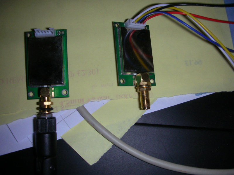

Hooner Posted April 21, 2009 Author Share Posted April 21, 2009 RDT equipment is the best out there imo.We have a camera looking down the digging area on a mining site and have not had any problems. Distance 2k. Their tech support are good to. Thanks for the recommendations guys. I went up this afternoon. Seems there is a transmitter there for the data after all. Trouble is it's goosed. There is the usual COP AV transmitter and receiver, which surprisingly seems to be working well. Then there is this for the data, the receiver has packed in and wont power up. Thats how it was found at either end, shoved in an IP66 box with just the aerial attached and the four wires twisted/crimped to the power + and - and data + and -0 To get an idea of size, each unit is not much bigger than a 50 pence piece. No markings on them at all, so God knows how I'm going to get it replaced under warranty for the client. It's been in less than 6 months, client thinks it was also sourced via COP, but I can't confirm this until tomorrow (it's not something I've known them to stock). From testing the 'working' Transmitter it seems it's a 7.5v unit. ________ Link to comment https://www.thesecurityinstaller.co.uk/community/topic/28259-wireless-telemetry-for-remote-ptz/#findComment-234362 Share on other sites More sharing options...
Hooner Posted April 21, 2009 Author Share Posted April 21, 2009 After doing a bit more research on the COP website, it looks like the boards above are infact 15-2400MTS' AV transmitters. (however I will need to confirm this with COP tomorrow) How the original installer planned to get them to work for Telemetry is a mystery. ________ Link to comment https://www.thesecurityinstaller.co.uk/community/topic/28259-wireless-telemetry-for-remote-ptz/#findComment-234367 Share on other sites More sharing options...
