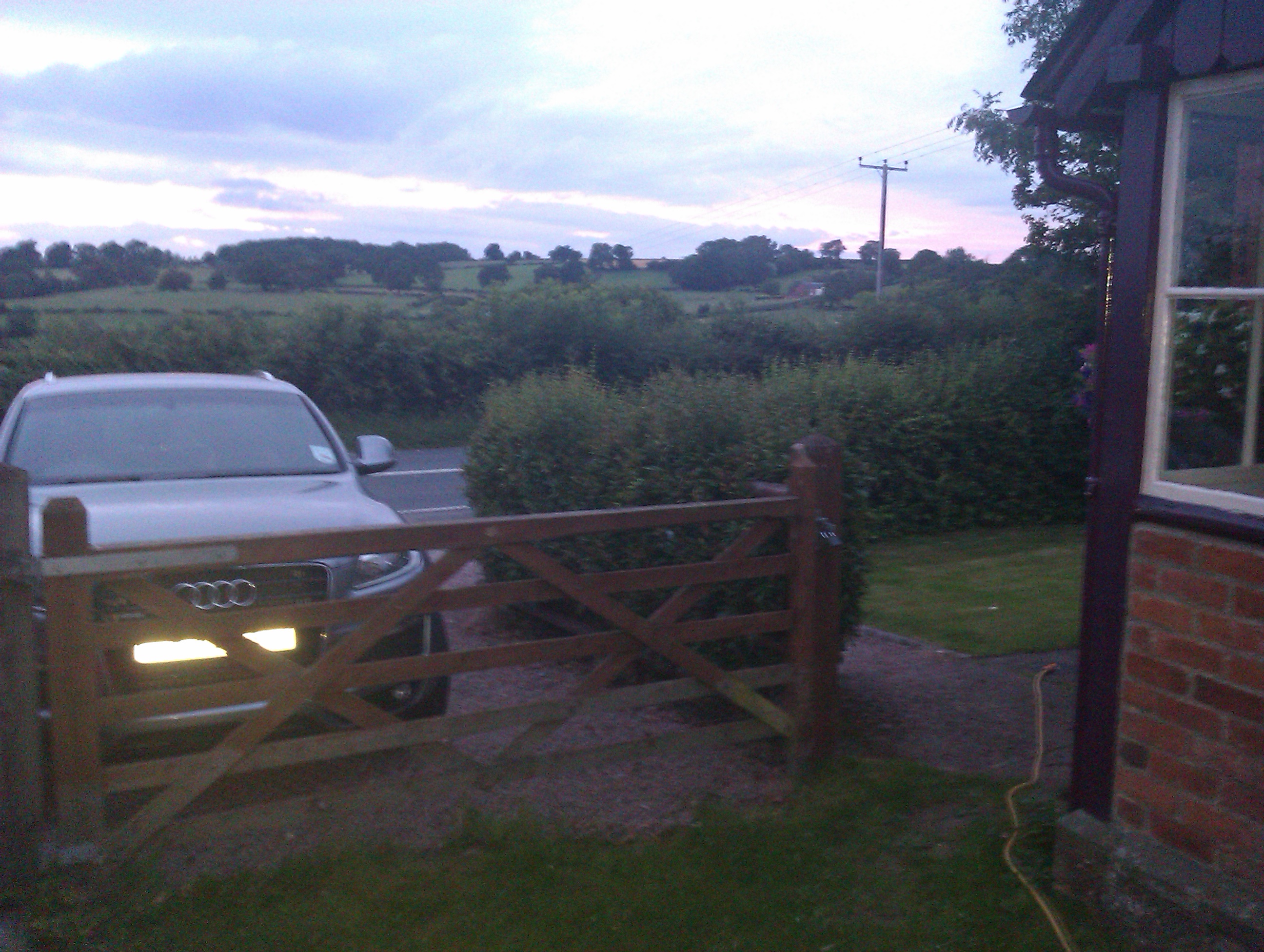

james.wilson Posted July 26, 2010 Share Posted July 26, 2010 it will be moved out approx 3m. Im thinking of an arm etc, but I have 3 kids, safety is paramount. Ill sort the controls etc but looking for advise on the best way etc. securitywarehouse Security Supplies from Security Warehouse Trade Members please contact us for your TSI vetted trade discount. Link to comment https://www.thesecurityinstaller.co.uk/community/topic/29441-need-to-automate-my-gate-home/ Share on other sites More sharing options...
Guest Oxo Posted July 26, 2010 Share Posted July 26, 2010 Go underground. Came-Frogs Nice-Hippo Get a bracket made for base of gate to sit on motor spindle. Change top hinge for a wrap around = no moving parts (as such) to get fingers/arms trapped in. Are you going to "close board" the gate. If so is it windy there, could cause a problem. Hippo I think is the safer with a 24vdc motor. 90 degree opening or 180 ? Either way it just means adjusting the hinge geometry. So think about that for the future. Easier to do all in one go. Get the Ariel up high, will mean the gate is open as you get to drive rather than wait although that looks a quiet road. Use the pre flash warning facility and maybe a buzzer and "train the children to keep away when they see/hear it. Soon it will become second nature ( yes I know they are young still, and will not be out there for a while). Link to comment https://www.thesecurityinstaller.co.uk/community/topic/29441-need-to-automate-my-gate-home/#findComment-247017 Share on other sites More sharing options...
