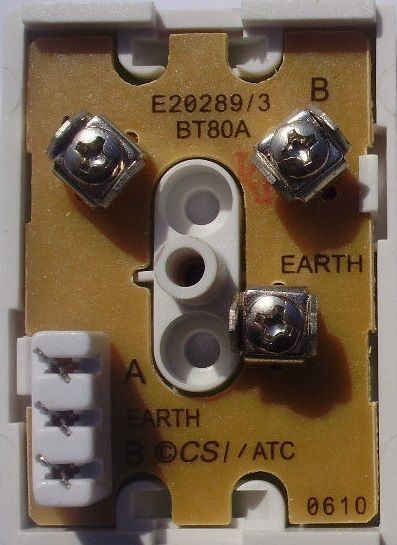

tim_timsen Posted May 15, 2012 Author Posted May 15, 2012 Where will the alarm integrate into the telephone line though? Through the faceplate of the main socket?
fozzies Posted May 15, 2012 Posted May 15, 2012 Impossible to guess im afraid. Find the alarm control box and see if you can trace a cable to a bt socket. In theory it should connect in at master, and your line should run through it, in order it can grab the line if needed, but in practice it probably just sits as anothe phone device connected to your line. Have fun!

MrHappy Posted May 15, 2012 Posted May 15, 2012 Where will the alarm integrate into the telephone line though? Through the faceplate of the main socket? oftend though a block termial Mr Veritas God
