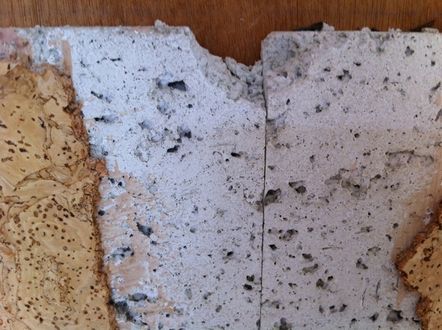

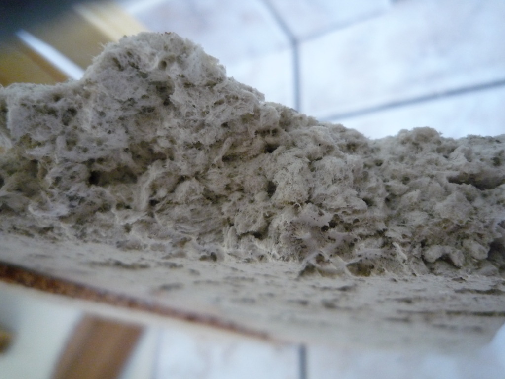

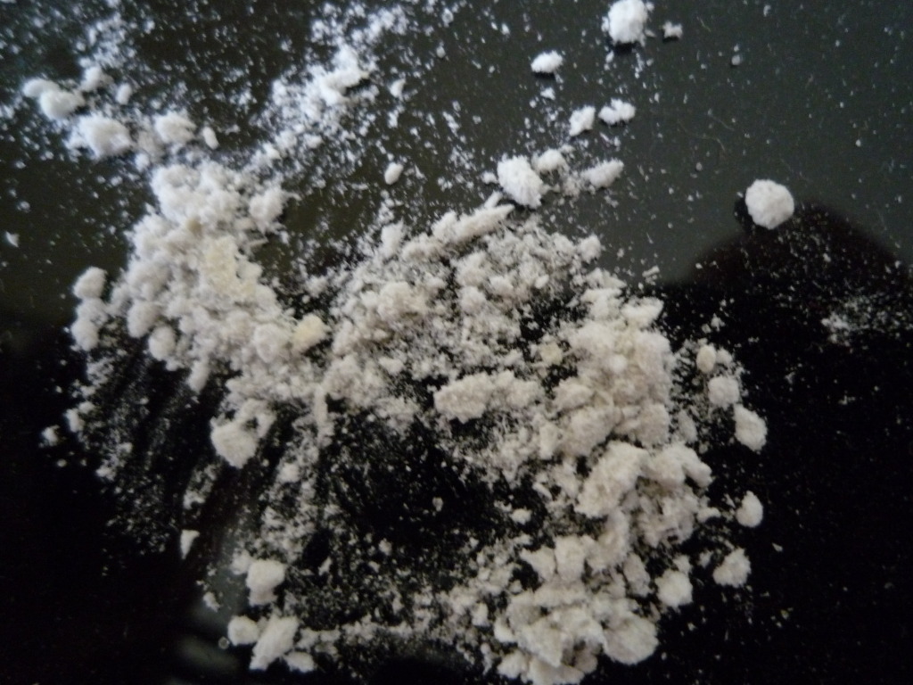

Driller Posted August 1, 2012 Posted August 1, 2012 Just bought an old doctors surgery to do up as a new practice, got the keys and thought I'd have at poke at a wall which needed a door put through with the keys to see if it was supporting or not. Found this under some cork tiles and had a good scrape Then I scrunched some up to show what the powder was like: And then the builder came along and said "careful, that's asbestos" It looked like this after after his blokes got it all off: Someone said it looked like christotile which apparently (hopefully) is not too nasty due to having straight fibres not curly ones.
PeterJames Posted August 1, 2012 Posted August 1, 2012 If that is asbestos you are in trouble. As it is in its worse state friable. Once the word was mentioned you should of A. stopped all work B. Employed a specialist contractor to investigate it. I the dust will be in the air for some time, be careful who you let enter this site because you could be held responsible for any damage caused http://www.hse.gov.uk/pubns/guidance/em1.pdf
