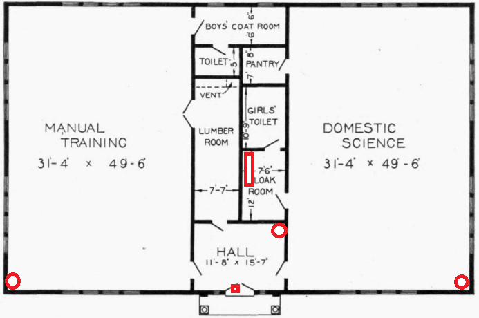

What i'm more interested in is your attack simulation. I've attached a layout with some devices and a panel on it. Choose any wireless system you've done and talk me through how your findings will allow you to break in to the premises and get to the panel room to access the safe that has my days takings etc in it.
