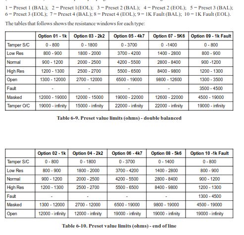

April 29, 201313 yr comment_317273 thanks matthew, so option 51/46 and what option will i have or can it be changed to other resistances ? All your options are right here www.securitywarehouse.co.uk/catalog/ Link to comment https://www.thesecurityinstaller.co.uk/community/topic/34444-can-a-galaxy-48-see-4k7/page/2/#findComment-317273 Share on other sites Share on LinkedIn Share on X Share on Facebook {lang="reddit_text" Share via email Share on Pinterest More sharing options... Share this post
