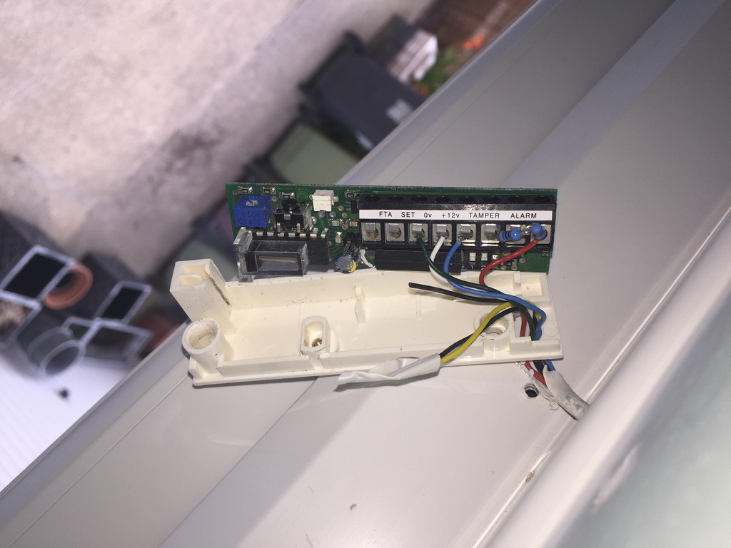

Vini Posted July 25, 2017 Author Posted July 25, 2017 On 25/07/2017 at 14:23, james.wilson said: the keypad isn't communicating with the panel Expand Hi James, I appreciate this, but I don't understand why this would be. Given that the keypad has not been touched. I appreciate that the peripherals are probably all linked in series... My wiring: Pos/+/12v == White Neg/-/0v == Green Tamper == Blue Alarm == Red I have no photo prior to the windows being changed, but this is how the sensor currently looks. The window fitter is adamant no wires have "come loose" and I have double checked that all the connections are tight. This is the only sensor that has been touched. I am confused as to why the keypad is now not playing ball. Does the keypad comm issue/*******'s prevent a full boot up also? I ask, as I have a network connection to the Panel, but this is no longer connecting. Quote
