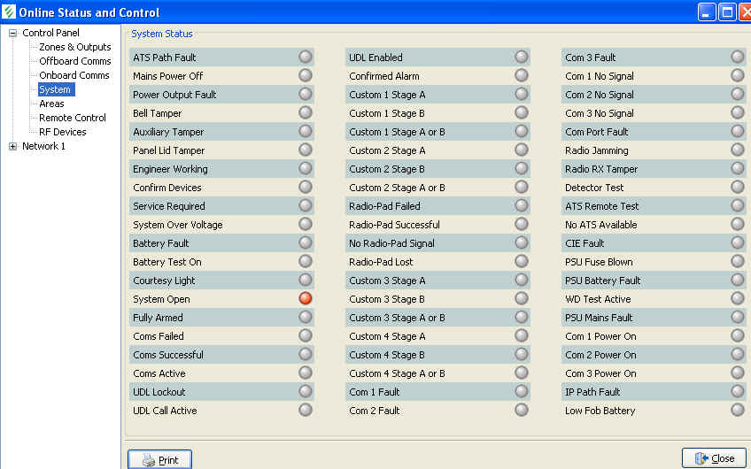

uwave Posted November 9, 2013 Author Posted November 9, 2013 Thanks - perfect answers to my questions 1 to 3 Now I know answer to 2 I do not need 3. My concern was if tamp caused external alarm if not armed......in case it was like my old alrm 24 hour tamper which went off if tamper whether alarm armed or not..but as my old alarm did not have battery in bell then I could kill it by turning alarm off. I was concerned in case this new alarm with battery in bell did sound if alarm not armed but I got a aux fault say due to bell battery or something. Anyhow not wanting to confuse - you answered Q2 perfectly and so my Q3 is no longer applicable. Q4 Picture shows what I refer to. Its a 24-W model with LCDP keypad Thanks again for any further replies.
matthew.brough Posted November 9, 2013 Posted November 9, 2013 System open means it is unset www.securitywarehouse.co.uk/catalog/
uwave Posted November 9, 2013 Author Posted November 9, 2013 Sorry for my ignorence - does unset mean not armed? (i.e idle/off because I'm in the house)
matthew.brough Posted November 9, 2013 Posted November 9, 2013 Sorry for my ignorence - does unset mean not armed? (i.e idle/off because I'm in the house) Yep www.securitywarehouse.co.uk/catalog/
