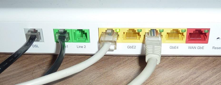

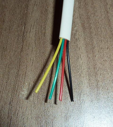

Tommygunn Posted July 15, 2018 Author Posted July 15, 2018 I think I know what the problem is. Prior to the change over the old modem and the phone connected to the main phone line via a filter, and the phone would work when the modem was switched off. Now, however, the setup is different and the phone is plugged into the modem Therefore, I'm thinking that I also need to have the dialler plugged into the secondary telephone socket on the new modem. Does that seem correct? Old setup with filter behind sockets: New setup with telephone connected to 'Line 1': So to test this I want to use a bunch of phone extensions to make an adhoc connection between the dialler and the modem to test for function before I go trying to feed wires though the walls/floor. The question is, out of a four wire telephone cable, which two are carrying the signal or which contacts of the RJ plug are being used; centre contacts, outers etc? Cheers, Tom. Quote
Tommygunn Posted July 15, 2018 Author Posted July 15, 2018 Just looked at the photo and saw that the Line 1 & 2 connections of the modem only have two contacts per socket, the centre contacts, so not to worry about that as I can easily use my multimeter to figure out which wire, in the photo above, goes to which contact. Tom. Quote
