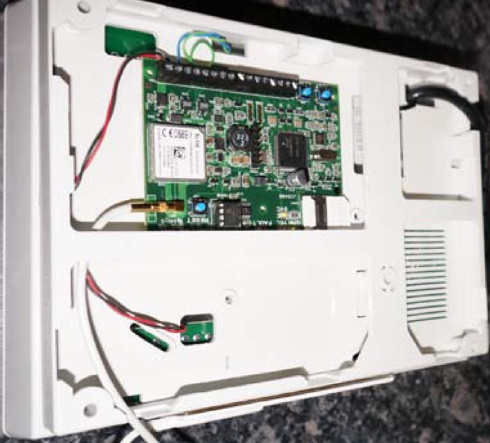

jiml Posted September 4, 2014 Share Posted September 4, 2014 You may be interested to know the digiair will fit in the spacer for the Enforcer. See attached. You have to strip it out of its little red box, but it works a treat. Just thought you would like to know. Link to comment https://www.thesecurityinstaller.co.uk/community/topic/37329-csl-dualcom-digiair-gprs/page/3/#findComment-399099 Share on other sites More sharing options...
datadiffusion Posted September 4, 2014 Author Share Posted September 4, 2014 You can have it on dialcapture with SIA and use the pins for fire etc Yes, I saw that. Although, it says to call them before you do it, but do you really need to? You may be interested to know the digiair will fit in the spacer for the Enforcer. See attached. You have to strip it out of its little red box, but it works a treat. Just thought you would like to know. Would a UDL version be of benefit to the Enforcer, i.e. does it support it? So, I've decided to take my work back underground.... to stop it falling into the wrong hands Link to comment https://www.thesecurityinstaller.co.uk/community/topic/37329-csl-dualcom-digiair-gprs/page/3/#findComment-399100 Share on other sites More sharing options...
Lwillis Posted September 4, 2014 Share Posted September 4, 2014 You may be interested to know the digiair will fit in the spacer for the Enforcer. See attached. You have to strip it out of its little red box, but it works a treat. Just thought you would like to know. Ideal ! we've recntly started fitting the enforcer On a side not will the enforcer take a wired expander or would it be better to use the euro 46 with a wireless expander? Link to comment https://www.thesecurityinstaller.co.uk/community/topic/37329-csl-dualcom-digiair-gprs/page/3/#findComment-399101 Share on other sites More sharing options...
jiml Posted September 4, 2014 Share Posted September 4, 2014 Would a UDL version be of benefit to the Enforcer, i.e. does it support it? It will. We need to tweek Insite to allow the comms from CSL. Working on it now. Link to comment https://www.thesecurityinstaller.co.uk/community/topic/37329-csl-dualcom-digiair-gprs/page/3/#findComment-399102 Share on other sites More sharing options...
