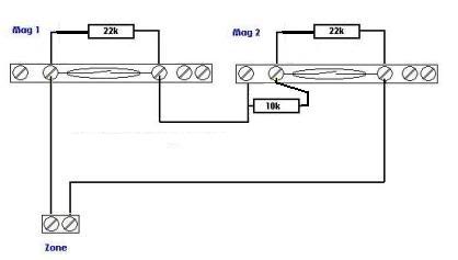

Mark02 Posted February 26, 2015 Author Posted February 26, 2015 Mark, the above is correct you 'can' loop it out with a resistor or program the input as not used. sixwheelbeast knows the better texecom stuff backwards. I would trust his info Hi James Not doubting anyone. Just trying to absorb info. I'm not an alarm engineer by a long shot and have never heard of EOL. I like to learn things and have a go myself hence I do lots of questions, reading etc before I play with things and do more damage than good. I will never make a living out of this (can you tell) I did the same when I first put stair carpet down in my house. Done all the rooms but didn't have a clue where to start going down the steps LOL I have just found this image on another forum and it's specific to the Excel unit I have. It shows 2 x contacts where as I am only doing one at a time. Looking at this it makes sense I think with an EOL resistor and a shunt resistor. I presume I need to follow the right hand side contact in this image including the fitting of the 10k inline. If this is right can I connect the 10k under the left screw or does it go externally to the contact block ? Edited to include image

james.wilson Posted February 26, 2015 Posted February 26, 2015 eol is just about values forget the above image for a moment and follow the circuit. if the circuit is closed (ie door shut) then the circuit resistance should be 10k. When the circuit is open (ie door open) then the current flow has to go through the alarm resistor (in this case 22k) so 32k is measured. Id say 99% of excel installs are done double pole not eol. Eol is a feature of higher end gear and the excel imho isnt securitywarehouse Security Supplies from Security Warehouse Trade Members please contact us for your TSI vetted trade discount.
