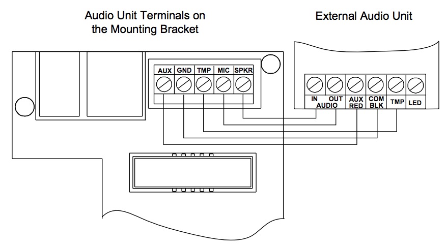

budda Posted February 21, 2016 Posted February 21, 2016 If I set DIP switch 2 to 'on' and wire up a simple phono cable to the SPKR and GND terminals I can link the Agility 3 panel up to the line-in on my Sonos AMP nearby. This allows the voice notifications and beeps to be played through a selected Sonos zone in the house (or group of them) which is lovely as my main Agility panel is in the loft far away from the front door. However if DIP switch 2 is 'on' and DIP switch 3 is 'off' I get a panel tamper alarm going off. This isn't discussed in the engineer manual so I'm wondering if there's some standard procedure i've missed regarding storing new DIP switch positions before power cycling or something ? Or is there something i need to do with the remaining external audio terminals? I couldn't see an official Risco device that connects up to all these terminals either - does one exist ? Quote

datadiffusion Posted February 21, 2016 Posted February 21, 2016 Suspect you need to connect GND to TMP at the panel end with a short length of wire? No refunds for broken panels mind, but highly suspect that is the issue. It may or may not need to be a resistor rather than plain link but doubt it. Quote So, I've decided to take my work back underground.... to stop it falling into the wrong hands
budda Posted February 21, 2016 Author Posted February 21, 2016 Suspect you need to connect GND to TMP at the panel end with a short length of wire? No refunds for broken panels mind, but highly suspect that is the issue. It may or may not need to be a resistor rather than plain link but doubt it. A link on the terminals was my suspicion - but can't find nowt about it online! Is TMP short for tamper by any chance? Do any official external 2-way audio devices exist for Risco ? Their website shows nothing. Quote
datadiffusion Posted February 21, 2016 Posted February 21, 2016 I did see some once - http://www.riscogroup.com/products/product/7821 TMP is Tamper, yes. I know nothing about Risco otherwise, used to fit Gardtec 816 but that all stopped approx 2002! Quote So, I've decided to take my work back underground.... to stop it falling into the wrong hands
budda Posted February 21, 2016 Author Posted February 21, 2016 Ah that looks like the thing intended to be hooked up to the Agility panel then - same wiring installation in the PDf diagram. I've shot an email over to Risco support on the off chance they can advise on any solution before I go poking the TMP terminal signal. Thanks for the link to the product -- I was looking for Agility 3 accessories so never saw this. Quote
