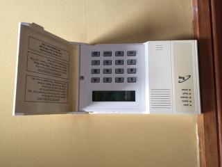

hufggfg Posted March 7, 2016 Posted March 7, 2016 Hi there, I recently moved out to the countryside from previously always living in central London, so now have a proper house for the first time. The house we have bought already has an intruder alarm system (in fact 2 systems I think, one in the main house and a separate one in the garage building), it says Banham on the external parts, but I don't know anything else about it. I think it was fitted around 10 years ago, and the old owner effectively just told us we can call any company we want to set-up a new maintenance contract. I've spoken to a couple this morning, and they weren't exactly incredibly helpful in terms of going through the different options and costs! I'm hoping to get some advice on who might be best to speak to about upgrading the current system, and the various options for maintenance & monitoring. I'm keen to have some kind of "smart home" set-up and would like to be able to access the alarm remotely (to arm it, disarm it, monitor etc etc), which I assume will mean at least replacing the control panels, but would it be better to just entirely replace the system? Does anyone have a recommendation of who I can talk to? Thanks very much Quote

PeterJames Posted March 7, 2016 Posted March 7, 2016 Hi and welcome The security industry was a bit slow to jump on the band wagon with apps and the like, but it has more or less caught up most of the main manufacturers now have apps. There is a signalling manufacturer developing an app that will work with any panel. Banhams are a NSI Gold semi national company which should mean your alarm has been installed to reasonable standard. If you really want a smart house with a bit of home automation then upgrading the panel using the existing wiring and detection would be the way to go. I would recommend the HKC app its slightly more expensive than the cheaper panels, but in comparison you do get what you pay for. Ive wired my panel into my lightwave RF system so can switch lights on and of from the same app rather than using two. Quote
hufggfg Posted March 7, 2016 Author Posted March 7, 2016 Ah perfect, that sounds like exactly the kind of thing I'm after, so good to know I can potentially get there by just changing the panel. We're now in Essex, about half way between Bishop's Stortford and Chelmsford. Also, I've noticed the motion detectors in each room make an annoying tiny click each time they detect movement... so might have to change some of those too! Quote
