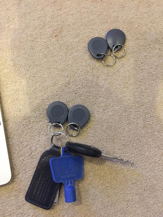

Hi, Ive just installed a scantronic 9651 in my house, the proxy tag that came with the keypad works a treat. Ive purchased 5 more cooper proxy tags to assign to other users. I have tried to assign them to different users but the keypad doesn't recognise them. There is no recognition from the keypad what so ever. Does anyone have any ideas?
Many thanks Toby
Can you upload pictures of the prox tags you bought and the one you had originally, must be incorrect fobs programming

I bought them from adi so they are authentic ones. Thought their might be a setting to allow more tags to be authorised or something. Thanks for your help anyway.
hi
in user menu  change code[ page 24 in user manual it is on line  ] you need master user code   set new user  code 2 to 48 can be tags   set user type and present tag instead of code hope this helps
