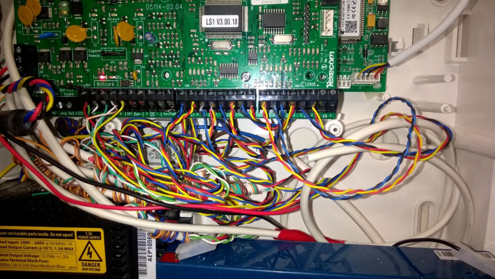

secureiam Posted May 7, 2016 Share Posted May 7, 2016 oh dear so you have the alarm red and black and tamper blue and yellow into the same terminals, how long were you in the industry? Link to comment https://www.thesecurityinstaller.co.uk/community/topic/40082-texeom-24-issues/page/3/#findComment-446005 Share on other sites More sharing options...
Phuddy48 Posted May 7, 2016 Author Share Posted May 7, 2016 as I said, I spoke to texecom and they told me that this was how it should be wired, maybe something was lost in translation and it didnt look right to me. I've been out of the industry for 5 years and tbh. As soon as you mentioned the tamper being in a separate zone I knew that was the issue. Going to the site tomorrow and changing it out. Thanks for your help folks. Link to comment https://www.thesecurityinstaller.co.uk/community/topic/40082-texeom-24-issues/page/3/#findComment-446013 Share on other sites More sharing options...
secureiam Posted May 7, 2016 Share Posted May 7, 2016 it doesn't make it any easier when the keypads and expanders have two for alarm and two for tamper and the 24 and the wireless panels just have the 2 terminals. Link to comment https://www.thesecurityinstaller.co.uk/community/topic/40082-texeom-24-issues/page/3/#findComment-446017 Share on other sites More sharing options...
Phuddy48 Posted May 7, 2016 Author Share Posted May 7, 2016 exactly my thought as well. It also doesn't help that there is no kind of wiring diagram apart from the eol and double pole terminations for the system. I knew it would be something extremely simple. Being out of the industry for so long doesn't help either. I'll be using the last two as a global tamper and hopefully that should cure it. Thanks again for your help. Link to comment https://www.thesecurityinstaller.co.uk/community/topic/40082-texeom-24-issues/page/3/#findComment-446018 Share on other sites More sharing options...

secureiam Posted May 7, 2016 Share Posted May 7, 2016 I would go eol to be honest, if the detectors don't have resistor the kit comes with 2k2 and 4k7 and 3k3, you can use the 2k2(eol) and 4k7(alarm), or 3k3 for both and wiring type would be double pole/eol, rather then wiring type as normally closed as you have suggested. then you are looking at a tamper you are only looking at one device. Link to comment https://www.thesecurityinstaller.co.uk/community/topic/40082-texeom-24-issues/page/3/#findComment-446025 Share on other sites More sharing options...
WDT Posted May 8, 2016 Share Posted May 8, 2016 Thanks for the photo, I did wonder if that was what you had done when you said the wiring colours, Sometimes a pic says a thousand words Link to comment https://www.thesecurityinstaller.co.uk/community/topic/40082-texeom-24-issues/page/3/#findComment-446036 Share on other sites More sharing options...
secureiam Posted May 8, 2016 Share Posted May 8, 2016 pictures certainly helped here. Link to comment https://www.thesecurityinstaller.co.uk/community/topic/40082-texeom-24-issues/page/3/#findComment-446045 Share on other sites More sharing options...
