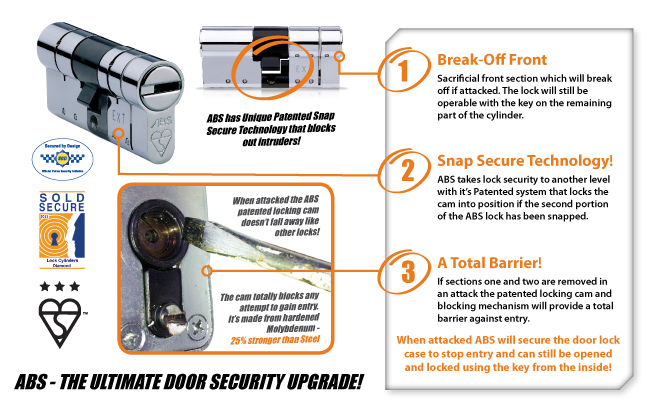

sixwheeledbeast Posted May 18, 2016 Posted May 18, 2016 I would be replacing the locks for 3 Star rated Euro at least, anyway. Quote
billy123 Posted May 19, 2016 Author Posted May 19, 2016 ALL DONE!....I took out the old cylinder locks which were unbranded and definitely looked like the old euro cylinder locks. now replaced all 4 of the locks with the AVOCET ABS locks....each cost £40! ....phew! Thank you! Now I need help with the burglar alarm system and would be most grateful if you could advise on my other thread. I'm trying to choose between the VISONIC POWERMAX or one of the POWERMASTER 10/30/33. Quote

sixwheeledbeast Posted May 19, 2016 Posted May 19, 2016 I rate Avocet they would be the Euro barrel of choice. Between Powermax and Powermaster it has to be the latter, it's two way other isn't, simple as. Quote
