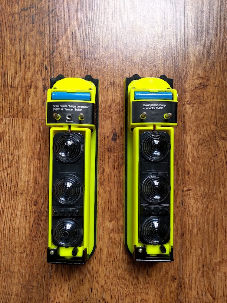

james.wilson Posted July 14, 2016 Share Posted July 14, 2016 can you upload a picture of inside ie any settings inside? Quote securitywarehouse Security Supplies from Security Warehouse Trade Members please contact us for your TSI vetted trade discount. Link to comment Share on other sites More sharing options...

mrbloop Posted July 14, 2016 Author Share Posted July 14, 2016 25 minutes ago, james.wilson said: can you upload a picture of inside ie any settings inside? Pics attached. Left one is receiver, right transmitter. The top lens on both has a red led indicator in it. Bottom two are the infrared related ones. The lens carrier can be swiveled horizontally and there is a thumb screw for adjusting vertical tilt. On the second photo you can see the jumper pins on the back of the receiver. Quote Link to comment Share on other sites More sharing options...
