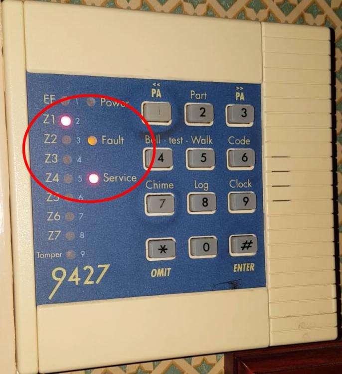

GregTK Posted August 1, 2016 Posted August 1, 2016 Dear All, Really hoping you can help me... Yesterday upon coming back home, I noticed that the Z1, Service and Fault LEDS were blinking on the remote control panel of my Scantronics 9448+ and the control panel didn't react to the code I use to switch the alarm off (or on for that matter). I was welcomed by a cacophony of different internal alarm sounds. Nothing I tried seemed to help. I quickly researched other default codes, engineer codes, etc but the control panel didn't react to any of it. Neither the control panel of the main 9448+ unit or the remote were reacting to key strokes / codes. As it was getting late and I couldn't see myself enduring this all night I took out the fuse (3A, mains to the unit) which silenced the internal sounders but then activated the external sounder (the latter I assume is normal). Oddly the PIR detectors around the house were then reacting to movement by sounding internal short audible alarms (as if in a sort of Walk Test Mode). The Z1 PIR detector that I use for the main Entry/Exit however triggers the Exit and Entry audible signal that is heard after fully setting the Alarm or upon entering via the main entry (short successive beeps). However, throughout the night - and for no apparent reason - the internal and external sounders would all of a sudden be triggered for mainly short bursts and then continuously around 5:30am... my neighbours must have really loved me this morning :-S The only solution I found to remedy this was pulling the 3A fuse out, putting it back into place, pulling it out again, etc. Basically faffing with the fuse until the system seemingly reverted into some sort of Walk Test Mode, but still not reacting to anything?! Remark: Mea culpa... I bought this property over 5 years ago and haven't changed the battery since then. Nor did I have the alarm serviced :-S It was just one of those things that always worked and I never took the inner workings into consideration... until last night that is. I obviously should have changed the battery and I should probably also have had the alarm serviced. I definitely learned my lesson! Any feedback on how to solve this in the short-term would be much appreciated. Even just being able to switch everything off without driving the neighbours insane would be a start really. (I have a second wireless alarm anyhow, but I like having both alarms operational) Many thanks in advance :-) Greg Quote

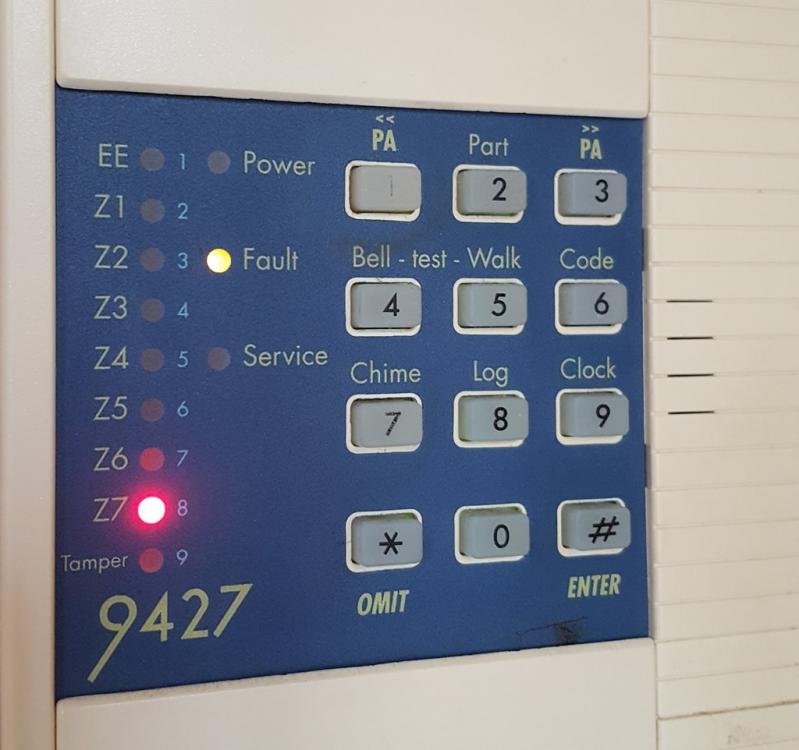

GregTK Posted August 1, 2016 Author Posted August 1, 2016 I have actually taken out the battery during my lunch break... at first it didn't seem to make any difference but now all of a sudden the default "1234" code worked on the main console and I managed to switch all the audible alarms off. Result! (the battery unit dated back to 1st July 2005... Over 11 years old! Oops!) With all my previous faffing I have seemingly reset the entire alarm system. Guess that will be an interesting learning curve trying to set everything up again ;-) The remote console now shows another fault with the Z7 LED continuously on and the Fault LED blinking. Might that get fixed by replacing the battery? Many thanks in advance for your feedback. Quote
sixwheeledbeast Posted August 1, 2016 Posted August 1, 2016 It would appear the battery has gone faulty and used your issue. It's possible that the unit is faulty, would be best to have it inspected to make sure the panel has kept it's programming and the panel isn't damaged. A new battery maybe all it needs but without proper testing you will not know if it's likely to do it again. Quote
james.wilson Posted August 1, 2016 Posted August 1, 2016 id guess circuit 7 isn't used and has defaulted to in use? Quote securitywarehouse Security Supplies from Security Warehouse Trade Members please contact us for your TSI vetted trade discount.

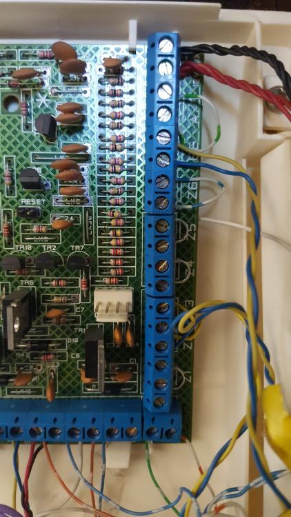

GregTK Posted August 2, 2016 Author Posted August 2, 2016 Hi James, 'sixwheeledbeast', Many thanks for your feedback. Correct, looking at the connectors inside the control panel, there actually is no Zone 7 connector (please see attached image). Should I use the Engineer Mode to Omit the Zones that are not in use? I should receive my new battery today and am looking forward to seeing how the system will react once I add a battery again. I guess I will have to set all the parameters again since I have had the system without mains and battery power at some point. This will allow me to make some changes and optimise for my own use I guess... silver linings ;-) I could obviously have called a professional to sort it all out for me but then I would not have learned about the inner-workings (and programming) and I do like the feeling of being a bit more knowledgeable in case my alarm starts going bonkers again at night. I had no idea where to start 2 days ago while now I kind of know where to look... I obviously would not be able to deal with major malfunctions and don't feel confident making any major modifications but I superficially understand how it works now. Again, many thanks Have a great day Quote
