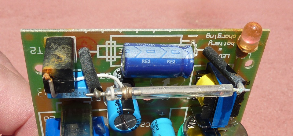

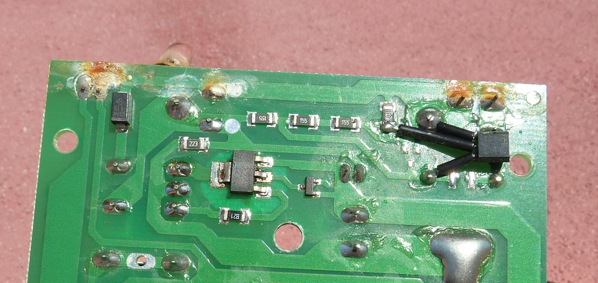

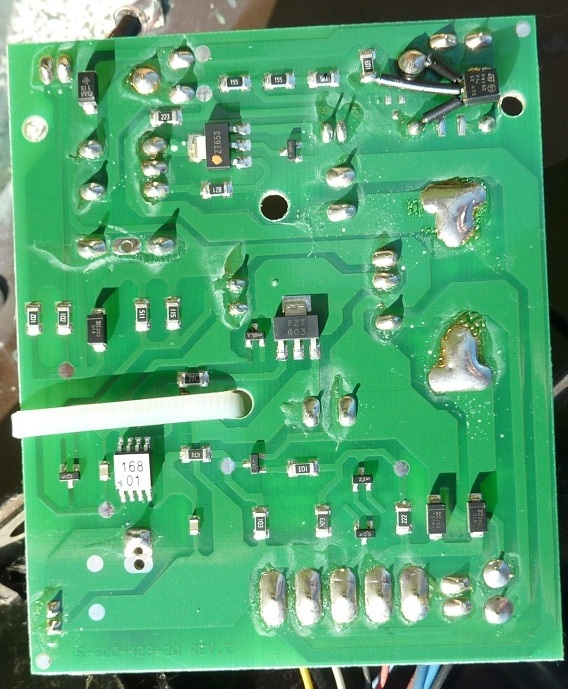

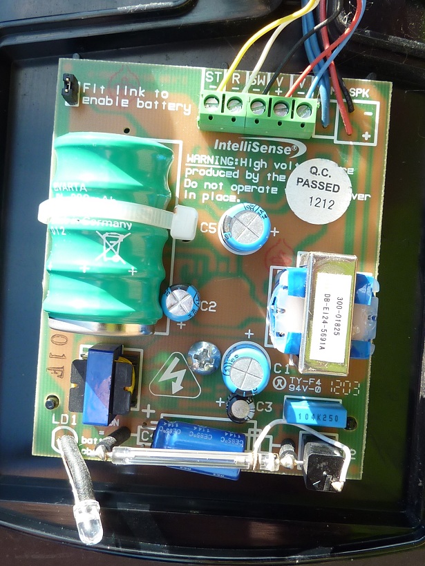

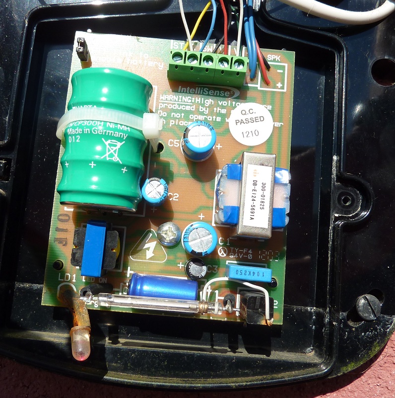

Tommygunn Posted October 22, 2016 Author Posted October 22, 2016 (edited) Ok, I've taken some photos and done some tests and below is what I've observed. First, I conducted a manual test of the bell boxes, via the LCD keypad option, and both piezos sounded at the same time with the correct high/low siren. I then did a full alarm activation and everything worked as it should except that the 'rear' bell box just gave out regular high pitched beeps while the 'front' bell box gave out the correct high/low siren signature. Also, of course, no strobes for either bell box. I also replicated AC power loss but to no avail, none of the bell boxes sounded. Front bell box: Fully functioning piezo, non functioning strobe and no water damage. Rear bell box: Partially functioning piezo, not during full alarm, non functioning strobe and water damage. Tom. Edited October 22, 2016 by Tommygunn Quote
datadiffusion Posted October 22, 2016 Posted October 22, 2016 (edited) Bottom two pictures definately have issues with water damage. Bin. Personally I would buy quality sirens like Texecom. Elmdene etc... where the electronics are enclosed. Edited October 22, 2016 by datadiffusion Quote So, I've decided to take my work back underground.... to stop it falling into the wrong hands
