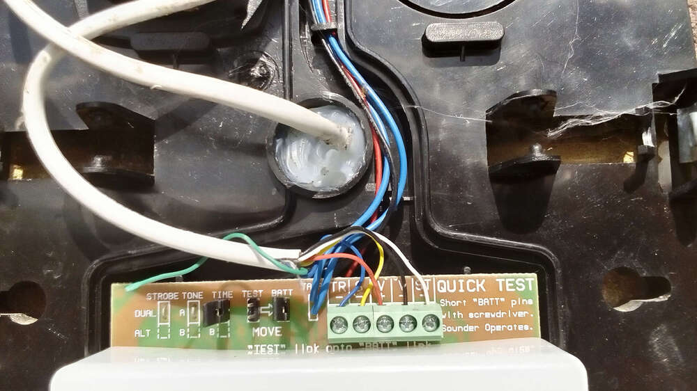

Standard problem with the ag6 with no eave protection or just when weather hits it
But then I have seen incorrect cabling , water trickles behind box , onto cable which trickles onto the PCB board on the ag6 , needs to be looped down out of the way really

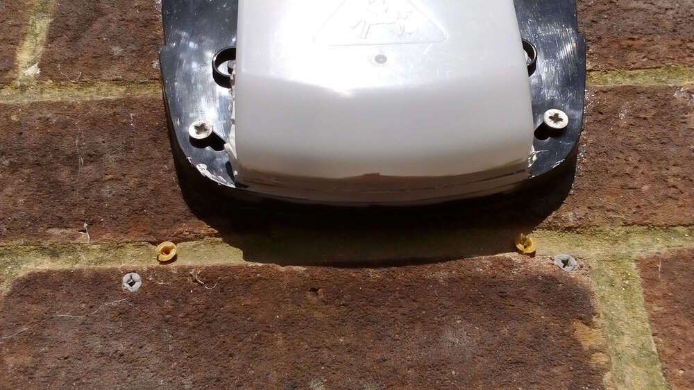

I agree - previously had to apply silicon sealant around rear of box and where cable enters (picture) as water did run along this.  The last two times the water has capillaried from the bottom edge into the bottom of the electronics board.  I have added more sealant today (picture).
Just wanted to thank all respondents for the info on this.  I have ordered a new Texecom Odyssey 4 to replace this with.
