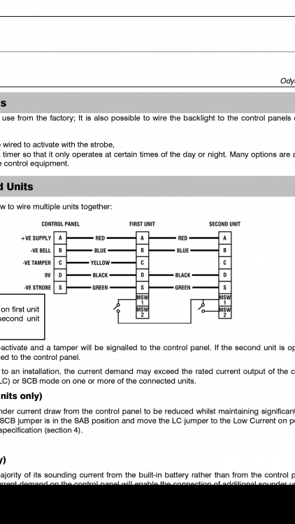

1animal1 Posted November 10, 2016 Author Posted November 10, 2016 Is the MSW the tamper? Ive already connected the 5 connection points Tamper,bell, strobe, 0v and 12v - leaving the 2 MSW terminals...these are the tamper circuit are they?
1animal1 Posted November 10, 2016 Author Posted November 10, 2016 (edited) Page 36 of the installation instructions shows the MSW as always empty...... on the Premier, Prem elite and sirens.... Edited November 10, 2016 by 1animal1
1animal1 Posted November 10, 2016 Author Posted November 10, 2016 (edited) no idea.... Texecom support said to connect them, but the FULL installation manual shows 3 diagrams for various siren circuits, 2 of which have these terminals - all with nothing attached to them. Looking it appears the X-BE Odyssey box is Grade 2, hence the lack of tamper relay - the X with a double siren, is grade 3, so imagine that will have the tamper relay. Think my only option will be to short the tamper circuit at the box Presume the single tamper wire of the 5 connected terminals will set my box tamper device stopping anyone (opportunistic) from messing with my front alarm box.... Edited November 10, 2016 by 1animal1
1animal1 Posted November 10, 2016 Author Posted November 10, 2016 (edited) So that assumes that it is indeed a tamper.....but more of a tamper between 1st and secondary units Edited November 10, 2016 by 1animal1
