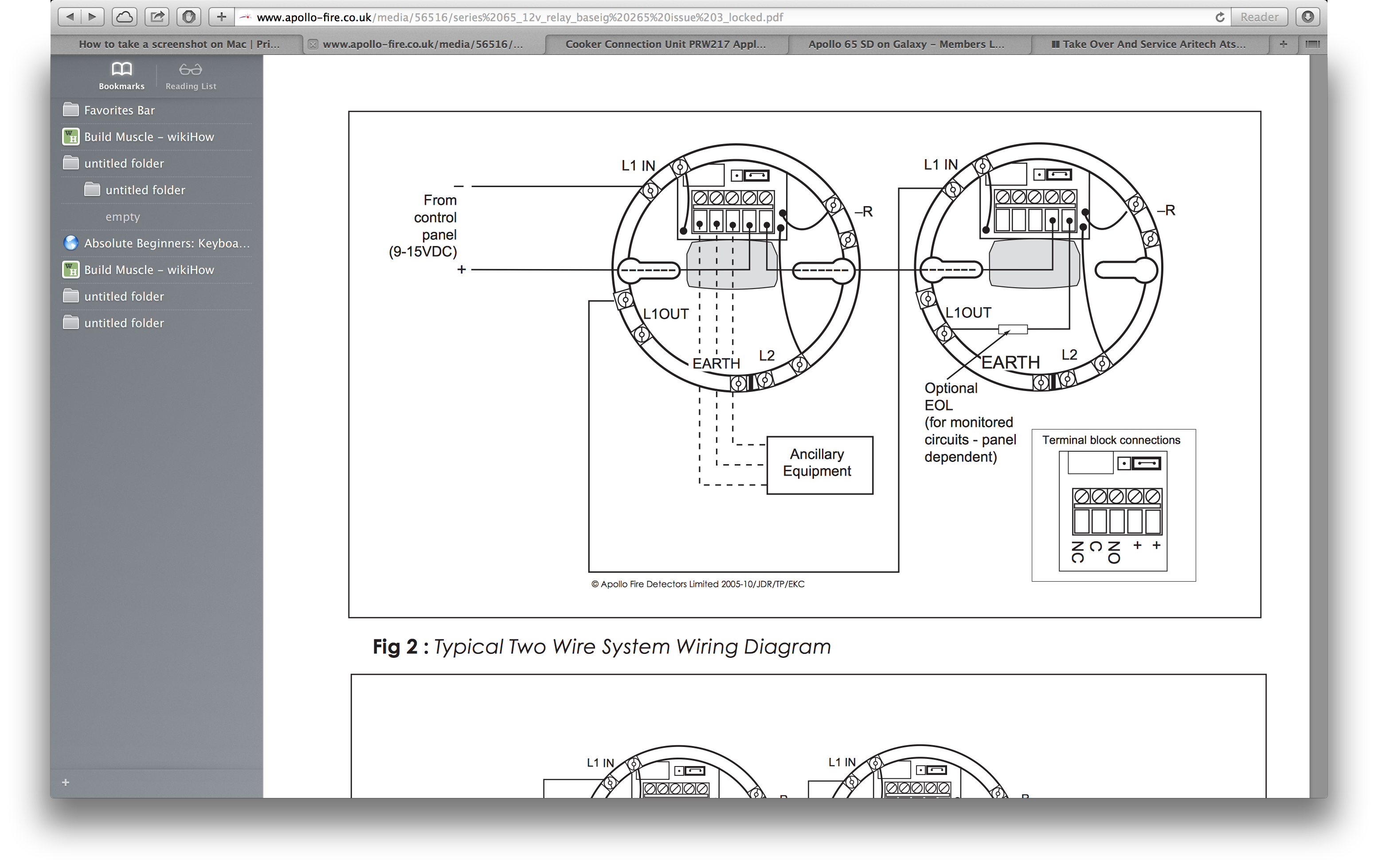

Litch90 Posted January 7, 2017 Posted January 7, 2017 Would this assembly work? I want my intentions scrutinised by the pro's before I carry out any installation. Apollo 65 Smoke detector wired to Galaxy G2 complete with resistors, Zone programmed as Fire then equally an output (1001) programmed as Fire with a internal sounder wired into it (I use Pyronix Twin Alert) . Smoke present.... Panel sees a fire activation so my sounder (in theory) will alert myself/the occupants? Do you gents recommend any particular type of SD detector? Just using Apollo as an example. Thank you Quote
james.wilson Posted January 7, 2017 Posted January 7, 2017 you will need a 12v base / clean switch but the theory is sound. just bear in mind you need them well placed as if the cable/panel etc get compromised it cant do its job Quote securitywarehouse Security Supplies from Security Warehouse Trade Members please contact us for your TSI vetted trade discount.
al-yeti Posted January 7, 2017 Posted January 7, 2017 Easier to buy a 12v detector or if you have existing mains smokes a relay base for one them providing you can get the cable to link it Quote
Litch90 Posted January 7, 2017 Author Posted January 7, 2017 7 hours ago, james.wilson said: you will need a 12v base / clean switch but the theory is sound. just bear in mind you need them well placed as if the cable/panel etc get compromised it cant do its job Thanks James, 12V relay base though surely? Quote

Litch90 Posted January 7, 2017 Author Posted January 7, 2017 Connections on this type of base... + -, say yellow & resistor leg into C, two resistor legs into NC, final resistor leg and blue core joined in choc block? Quote

datadiffusion Posted January 7, 2017 Posted January 7, 2017 4 hours ago, Litch90 said: Connections on this type of base... + -, say yellow & resistor leg into C, two resistor legs into NC, final resistor leg and blue core joined in choc block? When we used to fit 12V smokes & heats on Gardtec 816s and the like, we used these resistor packs from Elmdene I think (or was it Dantech?) which avoided messing about, they worked out about 20p in bulk IIRC. We used to fit quite a lot though. Quote So, I've decided to take my work back underground.... to stop it falling into the wrong hands
