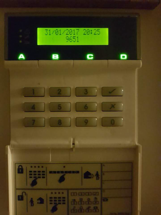

I have a Menvier 9651 alarm and since the carpet fitters cut through the wires, literally 1 sec after warned to avoid the wires, my alarm won't set.  It just flashes Done 01 z01    zone open z01.  I have managed to set it twice but its taken me 4 or 5 attempts before it did it correctly.

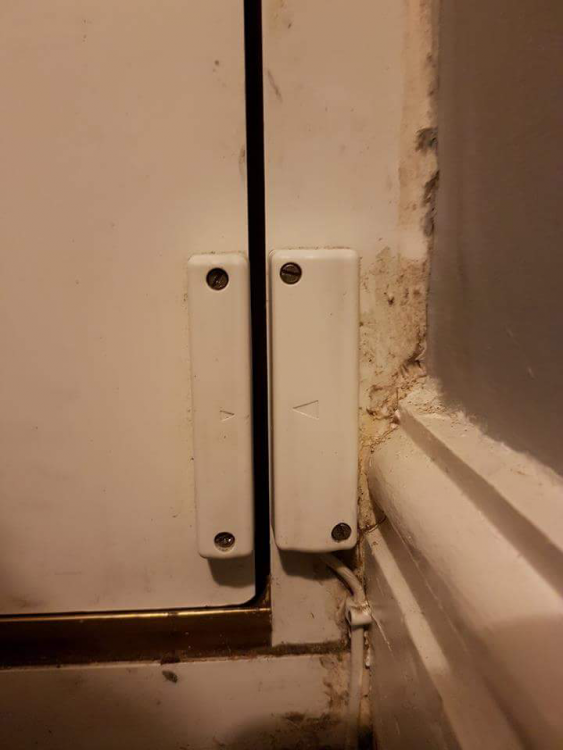

P.S It's most like a Scantronic 9651. Pictures of the door contact, repair, and keypad would be helpful.

I can't show the repair as its taped up!
