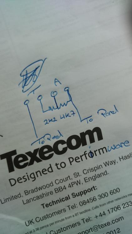

I'm using the texecom PIR's with built in resistors, so, if I want those to show I need to program them as 4k2/2k2 at the keypad? correct?
Whatever resistors you use in the pirs need to be set in the panel via keypad yes
You obviously have to use the correct terminals in the Pir also , not sure what model you have , but example you may have 10 terminals , you will be using two for power and two specific terminals for using eol , at least that's on some
I'm using the Texcom compact. 6 terminals on them. + - Al Al Tam Tam. set the resistors to 4k7 and 2k2 as in the manual and the door contacts are grade 2 with the wire cut for the resistance to 2k2.
So you have one leg on an alarm contact and other leg on a tamper , can't be drawing it lol
