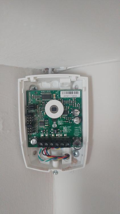

The jumpers on the board are set to 4k7 for the alarm and 2k2 for the tamper.
 do you have all 6 wire in the device ?
You do understand your not supposed to use all six wires , only two for power and two for the zone
If that's how the sensors are wired they are not wired correctly for EOL
We can't see the labels on the terminals or the DIP switches to see if there set right either.
All zones need to be Double Pole/EOL. I assume your using an Elite 24?
You need pair for power and one other pair across the Alarm and Tamper, look in the detector manual for guidance.
Thanks, I've changed the 2 PIR sensors across the alarm and tamper and it seems to be working better. I'm going to re do the door contacts tomorrow and then start the programming again. I'll update if I nee any more help. I hate intruder Alarm systems and this is one of the reasons why. :-o
