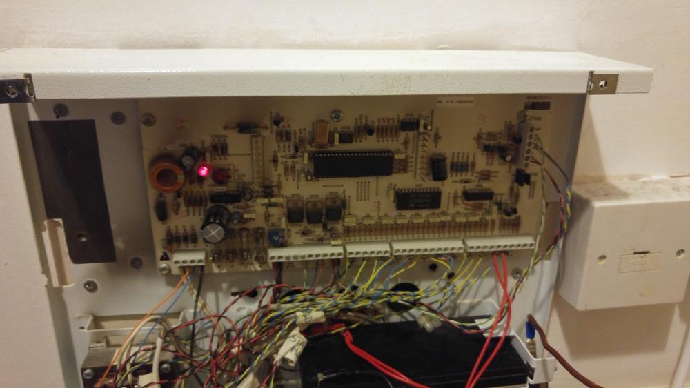

mdavies Posted March 29, 2017 Posted March 29, 2017 hi all moved into a property recently but the alarm boxes outside kept going off when there was a power cut/ did electrical work on the upstairs ring and the full alarm goes off when power comes back on. I read that this is due to a dud battery but on opening the alarm i found the battery was not connected, neither was the tamper switch. there are two very thin wires connected to the + which do not appear to be secured properly top anything and io do not have an engineer code. I can't see any labels on the board that specify what the make of the al[arm is and was hoping someone might recognise it. there is a date reference to Sept 2000 on it though. Many thanks mdavies Quote

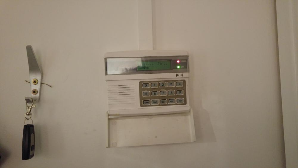

james.wilson Posted March 29, 2017 Posted March 29, 2017 pic of the keypad too? Quote securitywarehouse Security Supplies from Security Warehouse Trade Members please contact us for your TSI vetted trade discount.

MrHappy Posted March 29, 2017 Posted March 29, 2017 ADE something in metal box.... edit- Accenta ABI ? Quote Mr Veritas God
mdavies Posted March 29, 2017 Author Posted March 29, 2017 Here is the keypad. I realise it is not exactly cutting edge, but I figured lots of people have old alarms and someone might have serviced one or two similar alarms before. Bit of a longshot i know..... Quote
mdavies Posted March 29, 2017 Author Posted March 29, 2017 It may be a accenta mercury... I found this post where the board looks remarkably similar.. Next job is to sort out wiring then figure out how to clear tamper warning....,. Quote
PSE Posted March 29, 2017 Posted March 29, 2017 (edited) That's an ABI, Logo on left pcb corner Edited March 29, 2017 by PSE Quote
james.wilson Posted March 29, 2017 Posted March 29, 2017 its an ade or mdt not sure mind. Ive never seen that board Quote securitywarehouse Security Supplies from Security Warehouse Trade Members please contact us for your TSI vetted trade discount.
datadiffusion Posted March 29, 2017 Posted March 29, 2017 (edited) No doubt Mr Happy will be along soon to remind us that it used the same metal case as the Karizma. Probably a piece of sh#t if I'm honest, going on my vast experience. Possibly replace with Euro Mini. Edited March 29, 2017 by datadiffusion Who controls the past controls the future. Who controls the present controls the past. Quote So, I've decided to take my work back underground.... to stop it falling into the wrong hands
