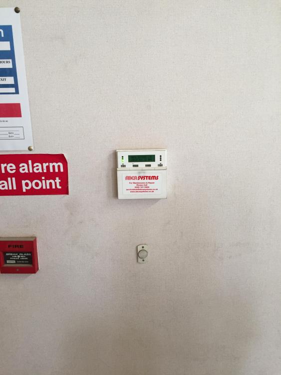

Zen Engineering Posted April 21, 2017 Posted April 21, 2017 Just wondered if anyone recognises the brand from the keypad picture attached?? ive searched high and low but no luck! Quote
sixwheeledbeast Posted April 21, 2017 Posted April 21, 2017 Yep, 9943 Keypad so Scantronic possibly 9751 Quote
datadiffusion Posted April 21, 2017 Posted April 21, 2017 Yep, not going to be a 9651 as it has Banner Text (unless, so unlikely this, it's a very late EN or recent PD, but looking at the state of the RKP, very unlikely to be the case) 9751 / 9752 / 9851 / 9853 probably... Quote So, I've decided to take my work back underground.... to stop it falling into the wrong hands
datadiffusion Posted April 21, 2017 Posted April 21, 2017 Very slim chance it could be a 65 / 85 / 95EN btw, I forget how the clock looks. If keypad keys have ENT and ESC its a 65 / 85 /95EN* *again, unless a VERY late replacement RKP when they just started using the 9x5x series key rubbers with Tick and Cross!!! Without seeing the top glass (as it's missing) or the keys it's hard to tell Quote So, I've decided to take my work back underground.... to stop it falling into the wrong hands
Lwillis Posted April 21, 2017 Posted April 21, 2017 I'm sure you could change the banner on the 9651- option 183-IIRC. Havent done one in a while tho Quote
aissecur Posted April 22, 2017 Posted April 22, 2017 Yes I have put banner text on a recent 9651 takeover Quote
datadiffusion Posted April 22, 2017 Posted April 22, 2017 22 hours ago, Lwillis said: I'm sure you could change the banner on the 9651- option 183-IIRC. Havent done one in a while tho Not on any UK model and only on later ENs, and all PDs. Quote So, I've decided to take my work back underground.... to stop it falling into the wrong hands
Lwillis Posted April 23, 2017 Posted April 23, 2017 22 hours ago, datadiffusion said: Not on any UK model and only on later ENs, and all PDs. Never took that much notice what variant they were if I'm honest mate. Quote
