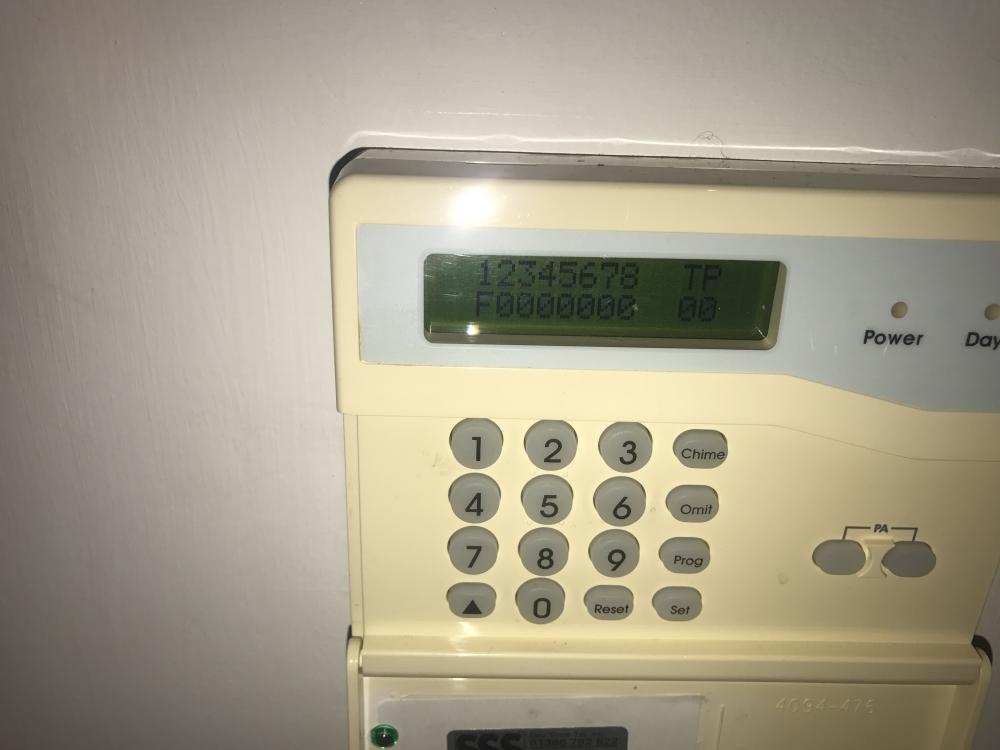

KB RED Posted May 6, 2017 Posted May 6, 2017 Hi I have an Optima/Accenta and in the last few days the alarm has just started going off for now reason (at midnight but at 3am yesterday). i have 8 zones and the panel reads like this after it has been reset 12345678 TP F0000000 00 Would really appreciate some help and advice. Quote
aissecur Posted May 6, 2017 Posted May 6, 2017 (edited) Hi, The display is showing zone 1 as currently open, so if this is what the displayed showed when you disarmed it I so would suggest its an issue with zone 1. Have a look at the detector that is zone 1, does there appear to be any damage to it or the cable that goes it it? Obviously speculating here & would need to be checked out properly but very possibly a faulty detector and or cable .. Edited May 6, 2017 by aissecur more info Quote
al-yeti Posted May 6, 2017 Posted May 6, 2017 1 hour ago, KB RED said: Hi I have an Optima/Accenta and in the last few days the alarm has just started going off for now reason (at midnight but at 3am yesterday). i have 8 zones and the panel reads like this after it has been reset 12345678 TP F0000000 00 Would really appreciate some help and advice. Can you not scroll through the "log" to see what activates at night? Or perhaps system battery Or as you say zone fault Quote
KB RED Posted May 6, 2017 Author Posted May 6, 2017 Wow - thanks for fast replies! Ok - when it went of I just put in the code to I set. Saw that error message and then pressed reset and the message then went and the display said 'system unset' i will check out the pir and the cable (the battery was changed 2 years ago) i will now check the log and see what that says and get back on here with the report. Thanks Quote
norman Posted May 6, 2017 Posted May 6, 2017 Or is zone one the PIR adjacent the keypad and picking them up? Quote Nothing is foolproof to a sufficiently talented fool.
datadiffusion Posted May 6, 2017 Posted May 6, 2017 I was going to say, 'fault' is stretching it a bit far as I assume all these range of panels are global tamper only*, so 'open (for whatever reason)' seems a more appropriate comment to make. *There was one, single, rareish, Optima that supported EOL though wasn't there? Quote So, I've decided to take my work back underground.... to stop it falling into the wrong hands
al-yeti Posted May 6, 2017 Posted May 6, 2017 6 hours ago, KB RED said: Wow - thanks for fast replies! Ok - when it went of I just put in the code to I set. Saw that error message and then pressed reset and the message then went and the display said 'system unset' i will check out the pir and the cable (the battery was changed 2 years ago) i will now check the log and see what that says and get back on here with the report. Thanks That don't make sense , you mean you have entered walk test and that's what picked you at keypad Must be getting old , I am sure in my earlier house bashing days that was walk test procedure , so better you look at log dude and find out why it's going off Quote
