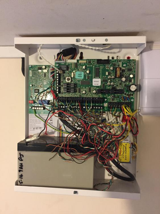

POC Posted July 17, 2017 Author Posted July 17, 2017 Ok, update. I put in the engineer code (no on screen confirmation that i was actually in eng mode?) Removed cover, no alarm. I was met with this mess (see pic). Upon pulling off the negative battery wire the alarm sounded saying 'control panel tamper, restore required' Now what? Anyone know of someone local to Hemel Hempstead that can fix this? thanks, Paul Quote
POC Posted July 17, 2017 Author Posted July 17, 2017 And the list of active faults: batt fault case tamper low volts batt critical restore required Quote
POC Posted July 17, 2017 Author Posted July 17, 2017 Right, got myself properly into eng mode (found instructions). removed battery and all is still powered, I'll buy a new battery and try that. Quote
MrHappy Posted July 17, 2017 Posted July 17, 2017 roughly 12 months ago...... may 2014? loving the extra long mains flex & screw missing from top left corner, Quote Mr Veritas God

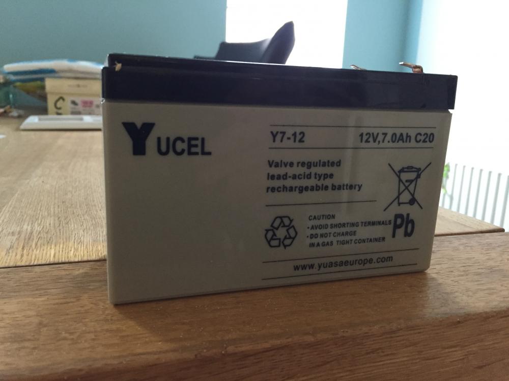

james.wilson Posted July 17, 2017 Posted July 17, 2017 and its on the piss OP as it says 9A/h on it I assume its a nasty battery? Does it rattle when you shake it? Quote securitywarehouse Security Supplies from Security Warehouse Trade Members please contact us for your TSI vetted trade discount.
POC Posted July 17, 2017 Author Posted July 17, 2017 Yes they've obviously used the battery from the old alarm. Here is the battery from the front: No idea why it says 9ah on the back!? Quote
sixwheeledbeast Posted July 17, 2017 Posted July 17, 2017 IBT reading was done in 2014 and read 9Ah. How old it the battery (code on the top) and does it rattle. Quote
