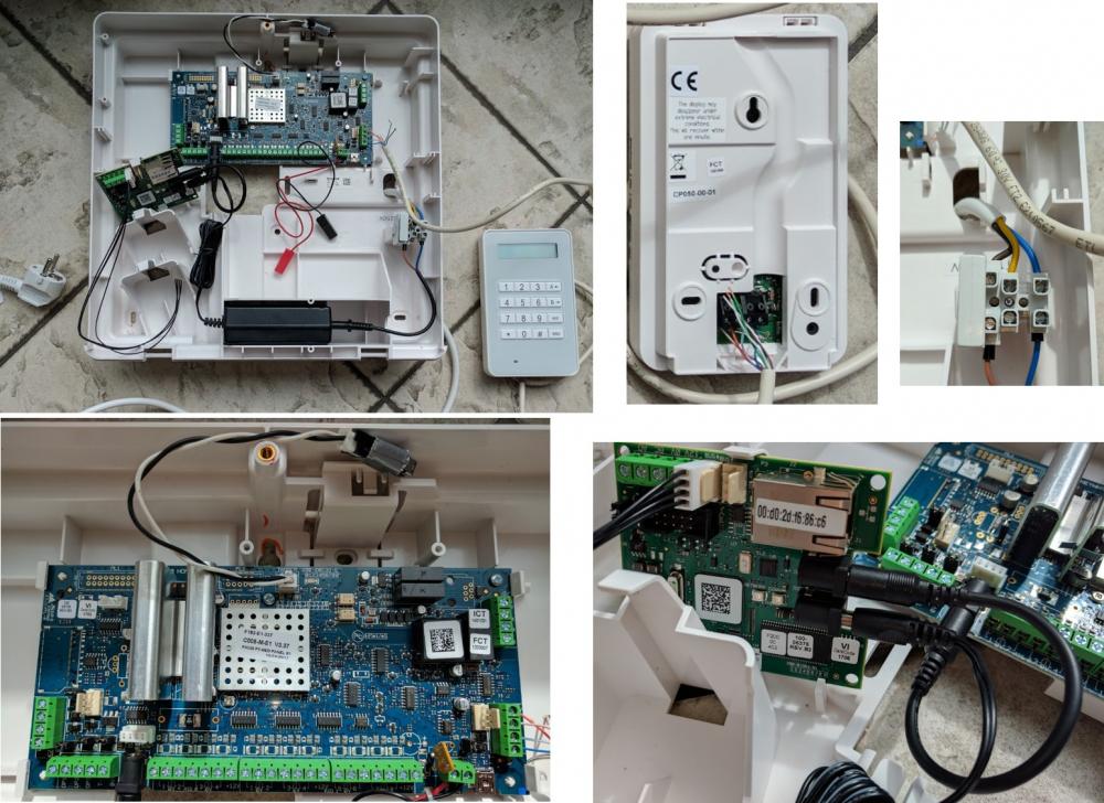

I've assembled the parts of the Galaxy Flex 20 I got the day before yesterday and am having trouble with the keypad. When powering up the system, it beeps and shows a bunch of "*****" on the lcd.
  1. I've connected the keypad to the PCB using Cat5, to the green terminal block on the right hand side of the PCB, with single strands to each terminal and I've put a 680Ohm resistor on the AB terminals of the keypad ( (please see attached picture)

I've made additional pictures, please see attached collage. Note that I have not connected the Ethernet module on purpose (first wanted to get the panel and keypad working without that potentially complicating things).

The LED flashes and doesn't stop after 30 seconds. I've waited over a minute and then took the power off. I hope the keypad isn't faulty, but it appears you are right.

Just to confirm this: It should be a single quick flash at power up, then the LED should go off for about 20 to 30 seconds while the firmware boots. After booting, the LED will then light constant, then after scanning the bus it will pulse quickly.

GalaxyGuy, thanks for describing the normal behavior. The way I first understood it was that you were talking about the LED of the Keypad. But I think now you meant the PCB and it behaves exactly as you described (quick flash, 30 or so seconds dimmed, then steady light - and I had disconnected the KeyPad).
Then I reconnected the Keypad and waited for about two minutes and then, after scanning the bus, the Keypad started showing initialization information about timezone and region, then rebooted. So, much progress, thanks!
