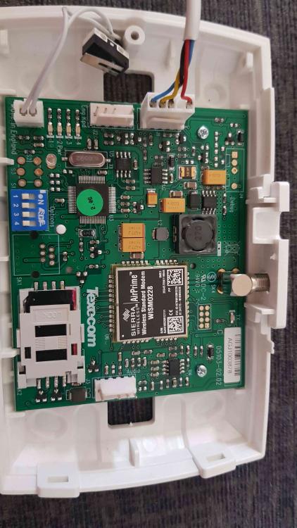

I put it into engineer mode, disconnected the communicator from COM1, opened it up, gave it a good old clean out and plugged it back in. The system happily accepted it and all was right in the security world. The device then started to throw this error again, and it grew more frequent, first a month, then a fortnight, a week, a day, an hour, and now it is a matter of seconds.

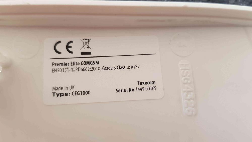

Picture of device: http://imgur.com/a/F3BU0
Picture of model: http://imgur.com/a/10vou

I literally mean what I said. I dismantled the device, ensured there was not dust between the sim card and any of the contacts, or anywhere else within the device or the system itself.

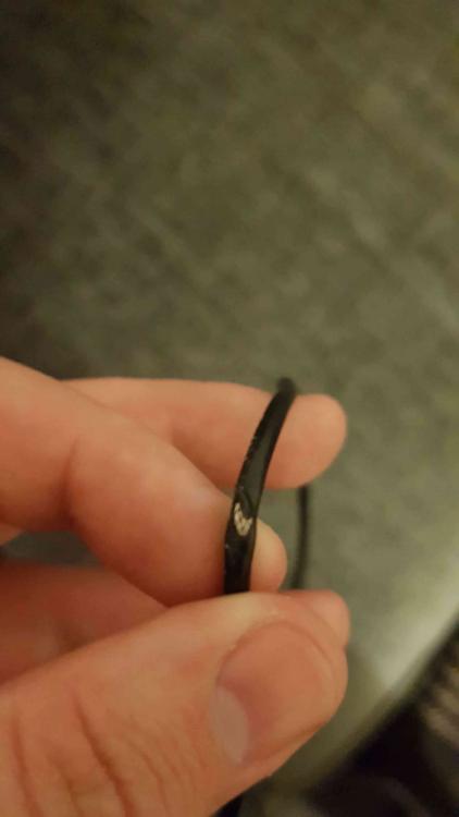

The antenna is the one which came with it: http://imgur.com/a/GivHQ - note; I am aware it is not screwed into the wall and this has been on my to do list, but as I previously said it was working perfectly for quite some times before the issues persisted.
If you think this could make a difference, I'm happy to go and get that done now.
My understanding with GSM is if it drops out, it will just reconnect at the first available opportunity.

The aerial could do with mounting correctly, making sure it's the right way round.

In regards to mounting the antenna correctly, this won't be a problem, however you mention "making sure it is the right way round". The manual I have doesn't mention mounting it any specific way. I have attached the manual I've been following.

T-Bar aerials normally have a indicator for ground, which should point down to the ground.
You can try different aerials but you have to be careful you don't create more issues.
For example, you could use a longer aerial (or extension) to get to an area of better coverage, however, the longer cable could decrease the benefits from that.
